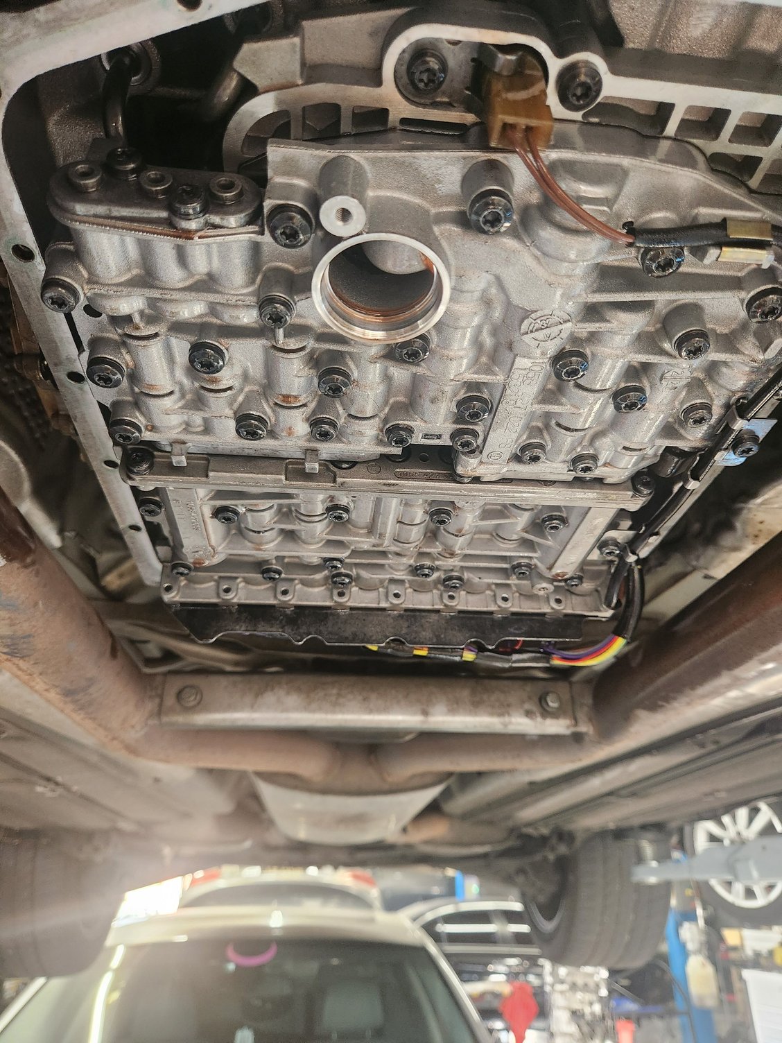

Get the car on a lift or on jackstands, level. Drain fluid, remove pan, remove filter. (Get the screwed up bolts out as best you can. To avoid screwing up the new ones, get a T27 1/4 inch drive bit. DO NOT attempt to use a T25.) Follow the instructions in the Transgo kit. There are about 24 bolts holding in the front half of the lower valve body. Remove them, pull down gently (there is a dowel in the upper right corner as you're facing it. Follow instructions for replacing the failing pressure valve. Replace the bolts in the correct holes. Torque the "large head" bolts to 8nm, and the small head bolts to 6nm. You will need a 1/4 inch torque wrench. BTW, all the bolts, small head and large head, are T27. BE SURE TO GET THE SHIFT VALVE ALIGNED WITH THE PIN ON THE SHIFT LEVER BEFORE YOU BOLT THINGS DOWN! Do not ask how I know this. Replace the filter and the pan, torqueing all bolts to 10nm.
Fill the trans until the fluid dribbles. Start the car. Run through the gears. Wait until the trans is above 40 degrees Centigrade, and less than 50 degrees Centigrade. Monitor this either by using a scan tool that will show trans temp, or in a pinch an indirect-read infrared thermometer gun can be used, pointed to the pan. It's not as accurate but better than nothing. When the trans reaches temp, fill the pan until it dribbles out (probably another 1 to 1.5 liters more), then close 'er up and take 'er for a spin.
CAVEAT!!! The above is if your trans is doing the occasional harsh shift. If it's shifting hard all the time, you may have something deeper. If the pressure spike problem has gone on too long, the A drum may break but before that happens a passage in the upper rear part of the valve body may split. If the trans is shifting harshly most of the time, especially in the lower gears, you'll want to check the following while you're inside the trans.
Disconnect the electrical connector at the rear of the trans, pull the U-clip, and push the connector back into the body of the trans. Then unbolt the VB. The large head bolts are the ones that hold the VB to the trans body. The small head bolts hold the VB "sections" onto the main VB. After you unbolt the VB you can remove it from the car, but be careful. It's a lot heavier than it looks. Once out of the car, look at the rearmost half of the VB. If one of the passages has a split in it (you can't miss it), then that portion of the VB MUST be replaced. Here's a link. These parts are getting hard to find. Both of them now say "email for price." 18 months ago I paid about $175 each.
https://www.thectsc.com/catalog/hardparts-32.html
To unbolt the upper rear half, it's done from the bottom. All the bolts that attach it pass through the corresponding lower rear half of the VB. So, unbolt from the bottom, then transfer all valves, clips, springs, etc., etc., etc. from the old to the new. BE CAREFUL. TAKE PIX. Don't ask how I know this. Bolt the new ones in place, torqueing the bolts to 6nm. Using all three of your hands, hold the VB up into the trans, feed the connector back into its hole, and get a bolt started to hold the VB up. Then align the connector correctly and push it through the trans body and secure it with the U clip. Finish bolting the VB into the trans. 8nm for the large head bolts.
This seems daunting, but it's not a bad as it sounds. However, it IS messy. And removing the VB will result in you needed an extra liter, more or less, of fluid.
