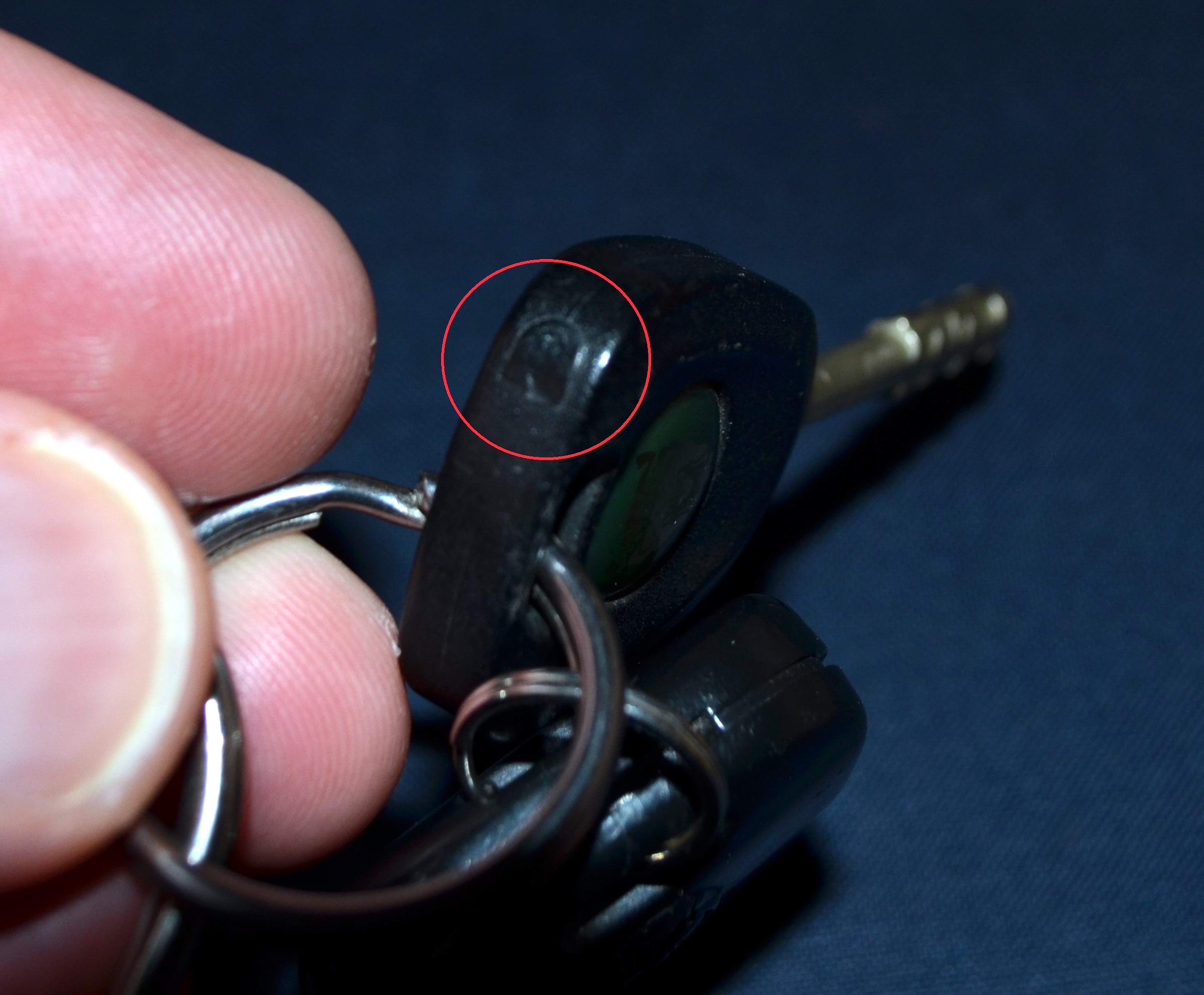

You should have a Transponder Key but, if the PO has used an aftermarket key, other things could have been done to bypass the security and locking system.
On a genuine Jaguar key, the chip is embedded in the plastic head under a small cover (circled in red)
Any sign of something similar on your aftermarket key?

You can take your existing key to a key / lock place and ask them to scan it in their transponder machine. If it has a transponder chip it will show up. The chip is what they call a T5 chip and can be supplied and programmed in most places, but the blank key cutting is the hard bit. You can get a chip programmed and put it into an aftermarket key by drilling a hole in the plastic head, and then filling it with epoxy afterwards. The key blank is called a Tibbe key.
I had a key cut and chip programmed recently, about $125 all up.
