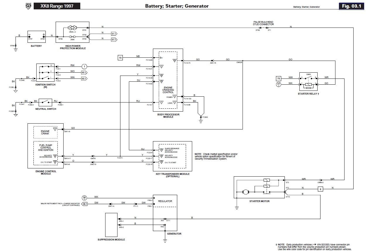

Default 1997 Electrical Diagram for Starting
Mike,
If both fobs are now bad, maybe you've done something wrong in re-programming the fobs. If you're sure you don't have a KTM chip, maybe then you're onto troubleshooting a bad start. May be coincidence.
Have you tried the hard reset?
Have you got a fully charged battery?
Try this excerpt from the 1997 XK8 Electrical Guide for where to look to trouble shoot a starting issue.
A lot of systems are involved in the start including the BPM.
Good luck, and hopefully some-one else can weigh in on re-programming the fob as that may be the root cause of your issue.
