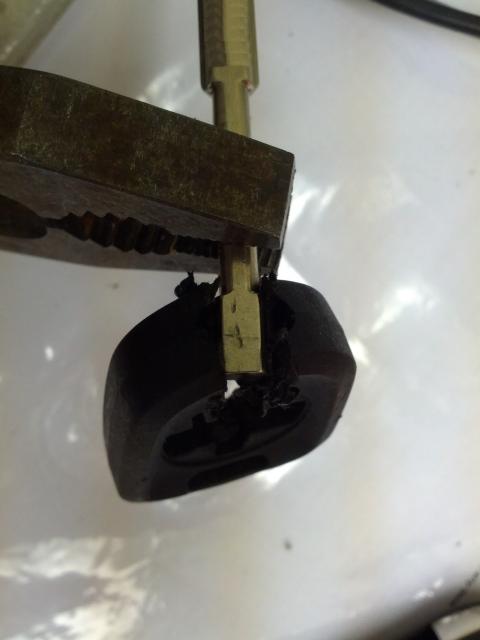

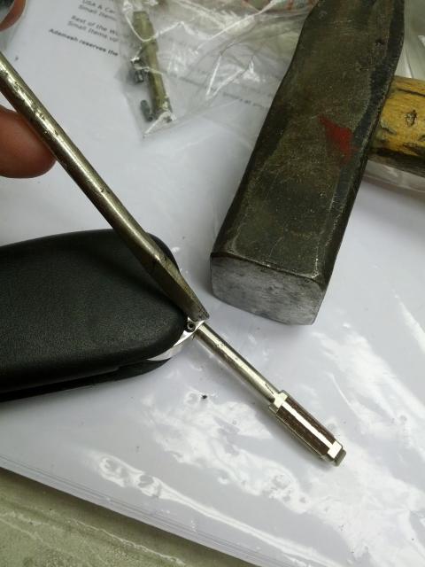

1. If your existing FOB came with a blade, you need to punch out the pin holding the blade in place.
2. Pry the blade from your existing key
3. You now need to slighly cut down the base of the blade (opposite end of the cut section). Also, you need to use a saw to make a slight cut in the side that will serve to hold the blade in the FOB via a pin.

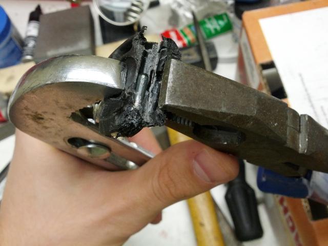

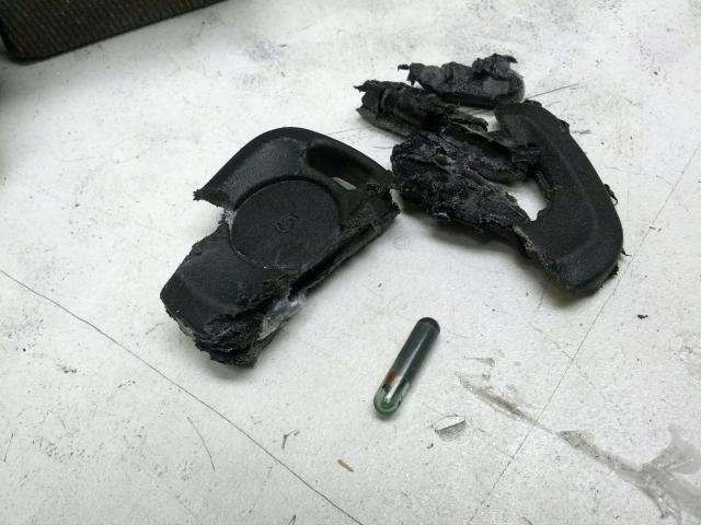

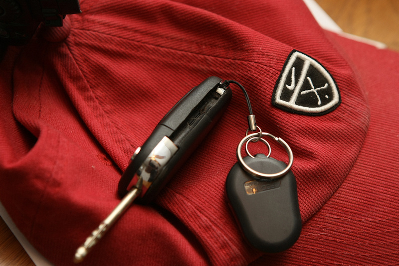

- Notice where the transponder is in the picture below. There is also a "plug" in the key grip in the area where the transponder was originally inserted.
- Use a heat gun to heat the grip slightly - it is plastic.
- Use a soldering gun to cut the plastic just above where the transponder is
- Use two pliers to split in the part where the transponder is.
5. Here is where the old transponder is in your new Key fob. Remove it. Insert your programmed transponder from your existing key. You'll notice the XK transponder is slightly longer, but that's fine.

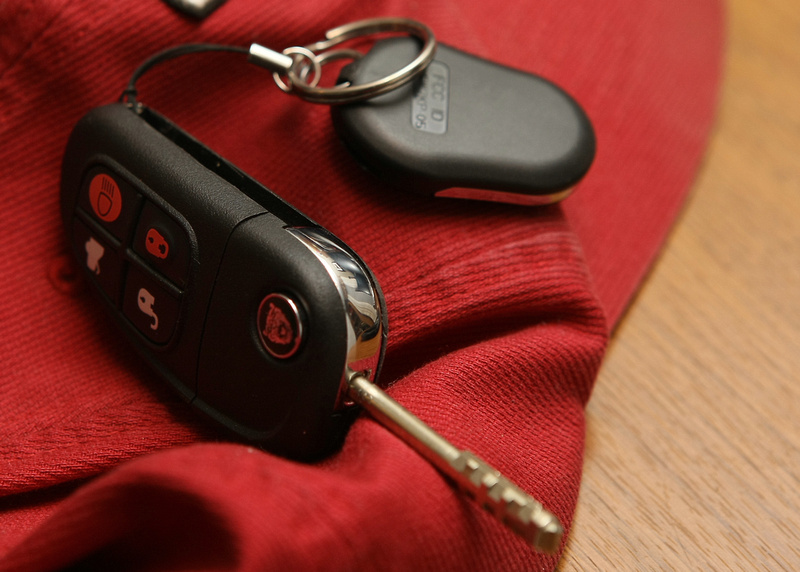

10. You're done! Final product:
Don't forget to program your new key using the procedure in the FAQ!
I'd like to add I've been using this key for over 3 months without a single issue. It's great not to have to carry around the bulky key with remote anymore! If you have any questions feel free to PM me. Cheers!

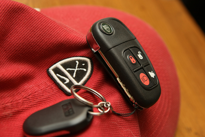

My new flip key is done! Thanks again pomosv.
To add a couple tips to this DIY project,
(1) I recommend cutting the old key to fit the flip base as short as possible while still being able to put that notch into the key to hold it secure. My first attempt left the tip of the key rubbing the chrome edge at the end of the key channel. You'll notice that pomosv also removed his round key ring from the FOB because there is no way this old XK8 key will fit with it still attached. Since I carry a lo-jack transmitter also, I opted to use a 'string' type attachment I had lying in a drawer.
And (2), competent Dremel skills are an advantage for this project (which I do not excel), where neatness counts in cutting the black plastic of the fob itself.
