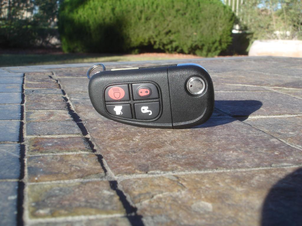

Well my conversion is underway I chopped up the valet key today using just a Dremel cut off disc. I'm still waiting for the new parts to show up.

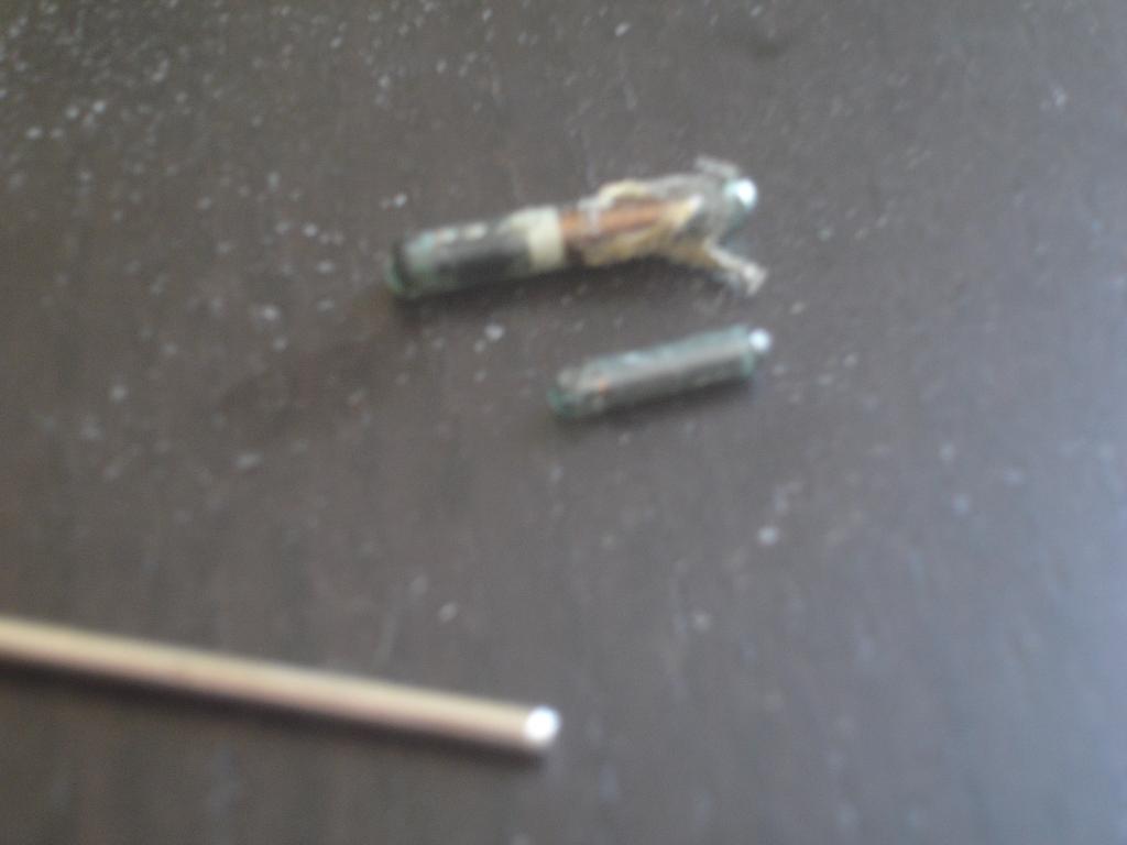

Mine is finished now, it didn't really take all this time!
I used xenophobes method and cut off the head of the key short enough to allow the pin to pass tightly in front of the large section with no slot.
This allowed the original keyring to remain as standard.
pomosv mentioned that the XK transponder was longer than the S Type one, mine was much smaller (bottom one in the pic) I wrapped it with a couple of turns of masking tape to stop it from rattling in the slot and fixed with a glob of glue.
I haven't filed off the tip to make it a universal key instead of just a valet so that's next.
