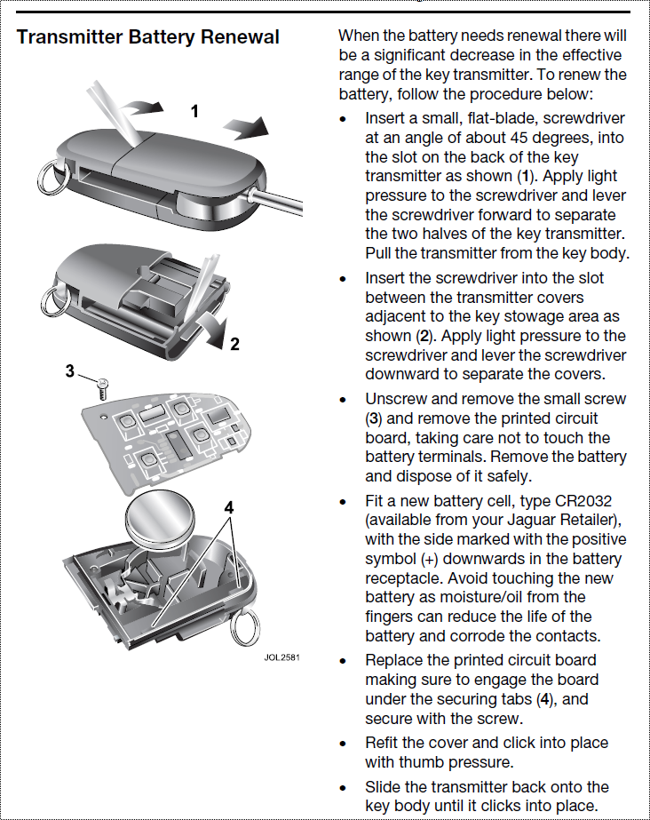

Default Changing the Battery
OK I feel kind of stupid but I can't figure out where the damn battery door is in this new fob. I figured it would be obvious. (I bought two used just in case I broke one).
[/QUOTE]
Old Jun 11, 2013 | 10:12 PM
  #35
clyons's Avatar
Joined: May 2011
Posts: 1,230
Likes: 155
From: Waterford, MI
Here's a page from the X-Type manual.
Attached Thumbnails DIY Flip Key Conversion without Reprogramming - Guide with pictures-screen.png
