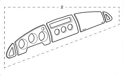

The veneer is originally fitted as a set - it matches across all 5 of the dash panels.
Not too noticeable provided it's the same wood but for example a Birds Eye Maple centre panel in a Burr Walnut dash can look strange.

Yes, I recommend you do no buy it without really good photos and a return policy. Both grain and color can vary significantly car to car, even with the same wood type. The grain will never be a perfect match without replacing the whole set, but have have seen some decent matches with careful selection that do not call attention to themselves.
