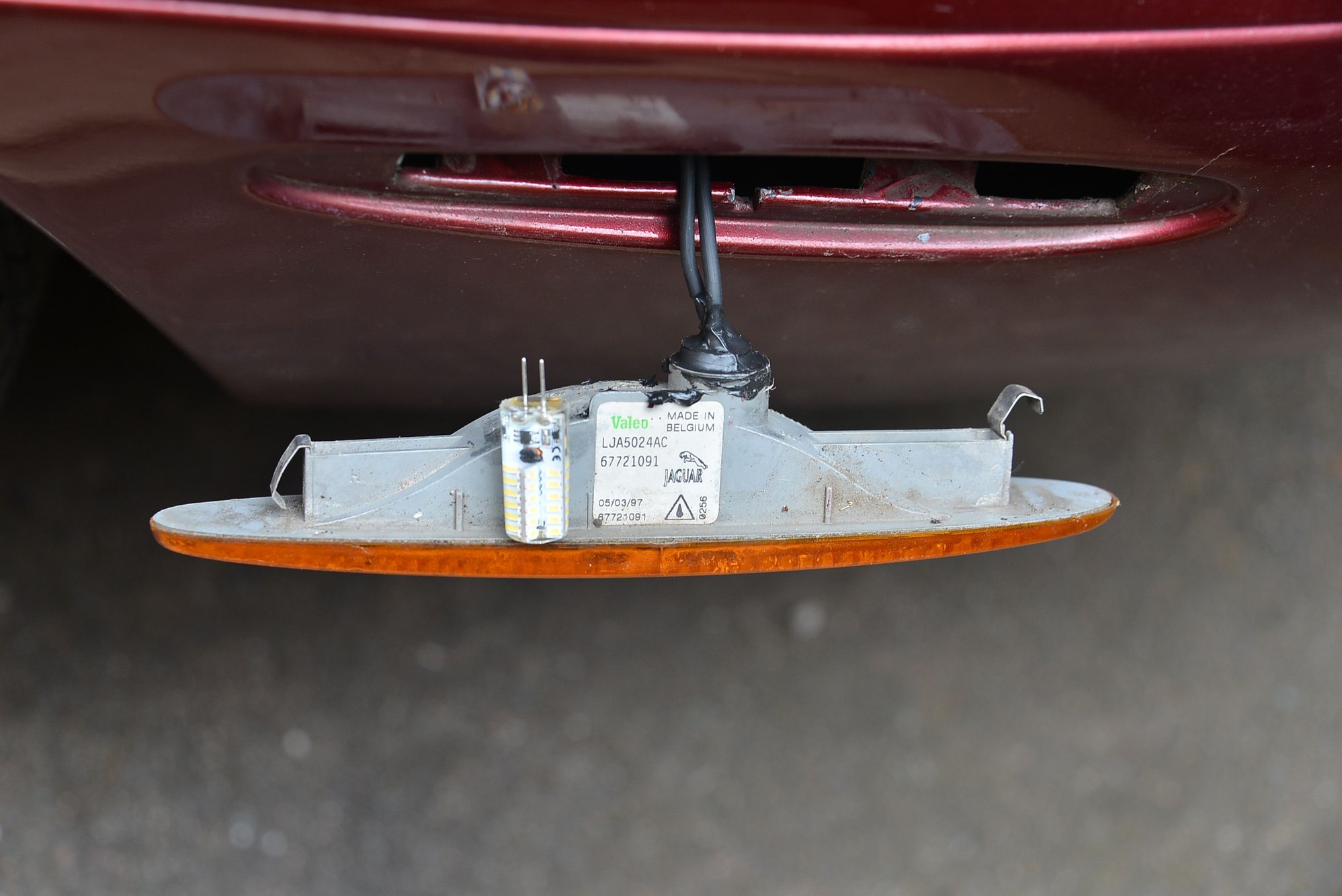

The front indicators on the XK8 are rather recessed and not easily visible from the side. Unusually for a UK vehicle it has yellow side markers which do not light and in my mind can cause confusion to other road users.
So I fitted LED G4 12v 3 watt AC/DC bulbs to them . Drill a 12mm hole where the american version would have a lamp holder and ease with a file ,the bulbs are rubbery and will press in.
I soldered wires on and siliconed around but you could use a holder. As they are AC DC it does not matter which way you connect the wires. Feed through to the indicator wiring front and rear and job done. They are very bright being equivalent to 30w.
I have shown the bulb to the left of its location position.

Well if it is I did no fined it ...on the rear there is a grommet through to the boot (trunk) so you can go through to the rear light cluster.
the front is more difficult you need to thread up to come out behind the light unit . I drilled a hole below the water shedder thing and siliconed it up . Used scotch locks onto the indicator wiring so it was removeable . Also put a bag (4in x 2in ) of silicone jell into the rear of the light unit to stop the condensation.
You must use AC/DC Corn bulbs ...here is the ebay item number.. You can see they are 12.5mm dia and like spongy plastic.
392923457743
