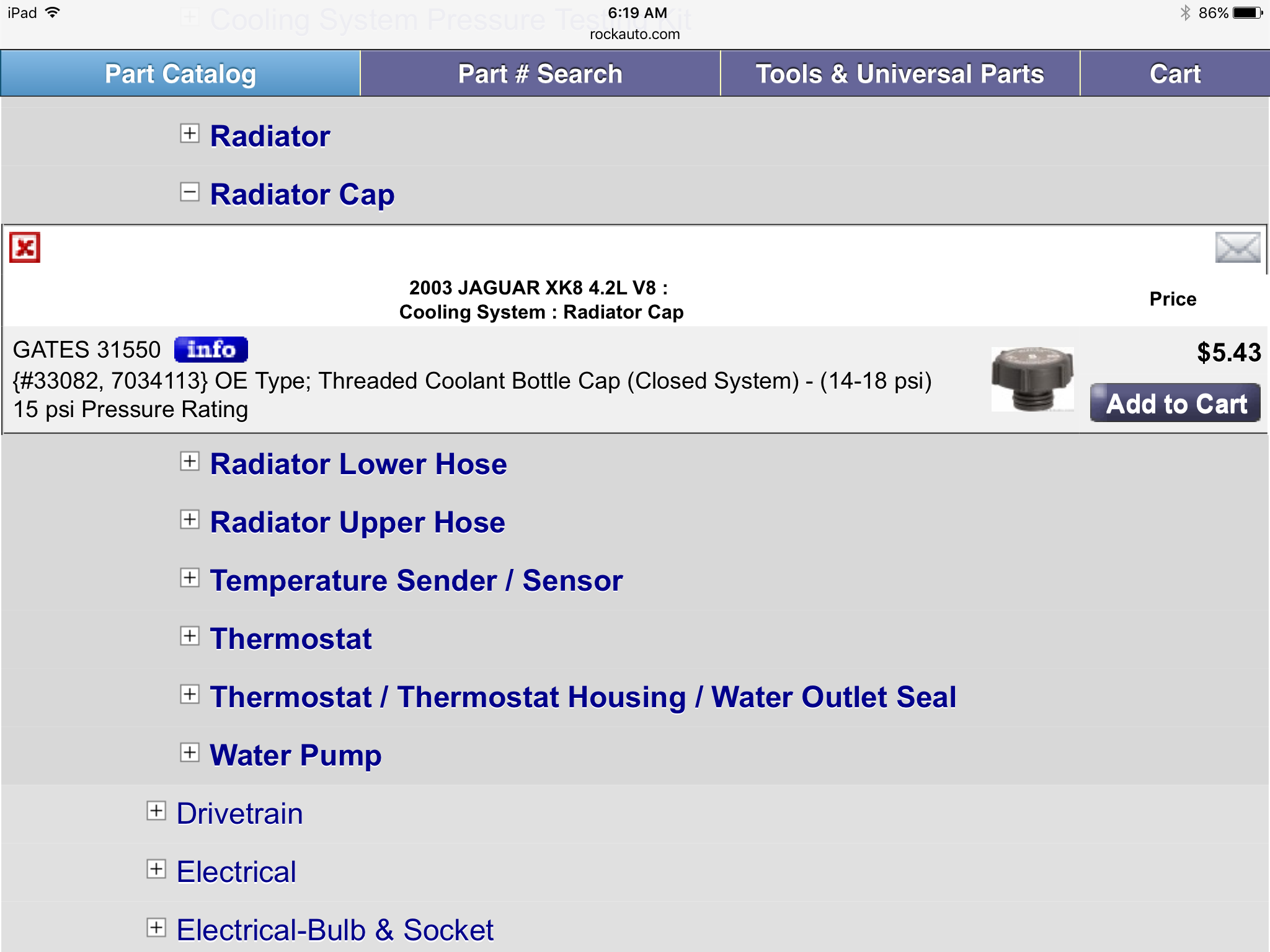

Old Feb 13, 2017 | 10:20 AM
Jandreu's Avatar
Posts: 2,173
Likes: 605
From: Goldsboro, NC
Order from Rock auto
