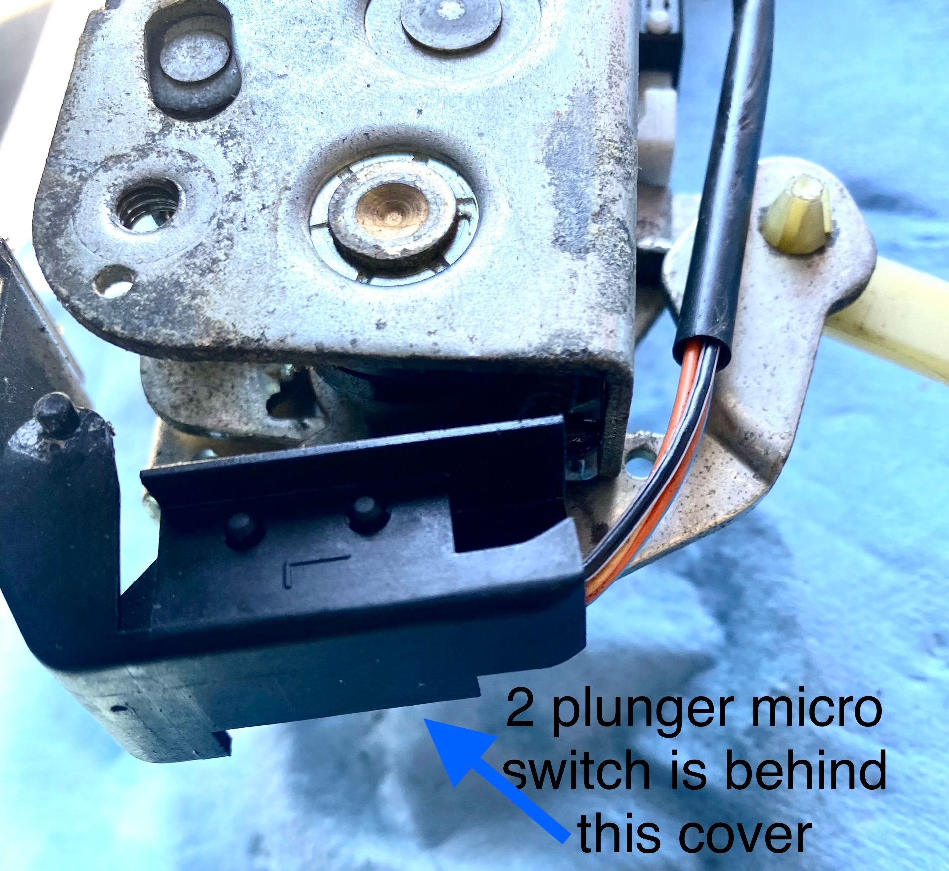

I recently posted on my weird 2 plunger microswitch in the driver door latch of my 97 XK8 coupe (build date October 1996) asking for help identifying it. I have not seen any info on this switch in the forums and internet. Here are photos showing the switch and orientation in the latch. I will appreciate any info about the switch and replacements.

2 plunger microswitch is behind this cover.
Close up of 2 plunger microswitch “cube”.
Orientation of the 2 plunger microswitch in the latch. The two plungers contact adjacent cams of different shapes. I don’t know what the cams and switch do. Can anyone tell us what this switch does?

I found this reference:
https://www.toneluckswitches.com/pro...e-microswitch/
But I think it is enough to use two three-contact microswitches (NC and NO) placed side by side. I have not tried it when I changed the switch that controls the lowering of the window when opening the door, but I have verified that the width matches. Two like this could work:
https://www.aliprice.com/s?id=100500...UeL8FB0whuBHBB
""WS1-Z0-W300R300"

Nice find! That housing on the original is to waterproof the switches. I don't know how exposed to water they are, but it's worth bearing in mind when replacing with something different.
