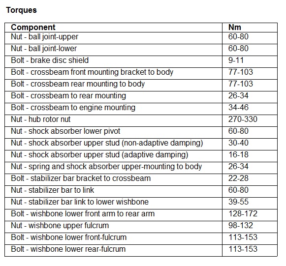

All genuine jag parts, had tracking done twice will check tyres etc only thing not torque wishbone do u have setting please.
Old Feb 13, 2015 | 03:11 AM
Here's the front suspension torque list for 1997MY:
With that work list you should feel a massive improvement, not the opposite. It sounds like a lot more than just something under-torqued.
