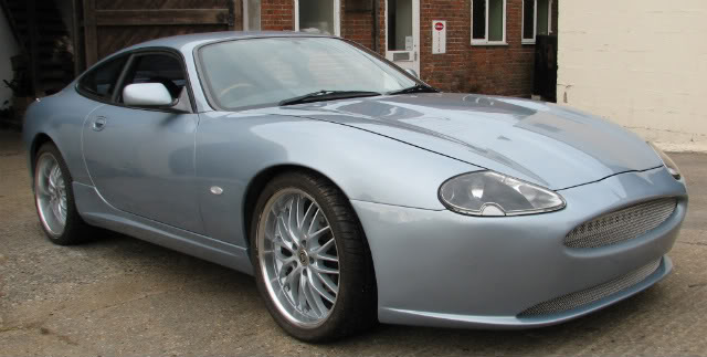

There are plenty, of companies doing lowering springs, for you guys in the US I guess Mina is your best bet still expensive by my standards.
You cannot fit a strut brace in the standard across the engine bay terms but you can fit the convertible bracing quite easily to give you extra strength.
Depends how much you want to spend, I did this to a 96 XK8

your XK looks great! and I saw your wide bodykit on Ebay for $3600. as far as strut brace from the XK convertible, are you talking about the oem one?

You did that to a 1996 coupe? There were only 2925 made that year It looks awesome, but 25 years from now someone is going to be scrounging parts to return it to it's original condition.

Not me on Ebay I am afraid, I have never sold my conversions on Ebay. And yes to the OE but I have produced something a little different, as below
All the connecting points are there on the coupes.
Look at it this way, I am actually preserving them, I am covering up and protecting all the nasty bits that normally turn to crap, so in time if someone wishes to put it back to standard they can, but I must admit as far as the XF light conversion goes, that would be a hell of a job and quite expensive.
I have quite a few early XK8 coupes around too, my track car was first registered in October 1996, which makes it a very early XK
