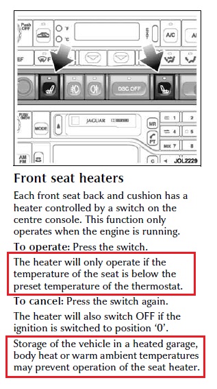

The Seat Heaters can appear to work in mysterious ways!
Regardless of the position of the dash switches, Heater operation is determined by ambient temperature (see sections boxed in red):
The Heaters will sometimes not operate at all or will cut in and out during a journey.
I've checked the Driver's Handbooks and a similar description appears in them from the earliest MY's.

So basically they only work when they feel like it

Oh no. In this litigation-heavy universe, you can imagine the berk that leaves the seat heater on until it burns his back and legs and then sues Jaguar because "there should have been a safety cut-out". A safety cut-out is simply a thermostat with a pre-set temperature, which is what the manual describes.
