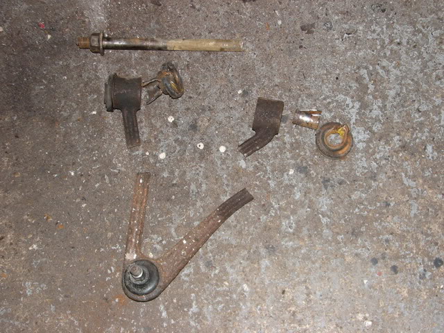

Quite often I do not have the luxury of time and to be fair the customer doesn't want to pay for it either so I often resort to more drastic routes
You can get secondhand wishbones with a fulcrum pin for around £40, I always keep one laying around
