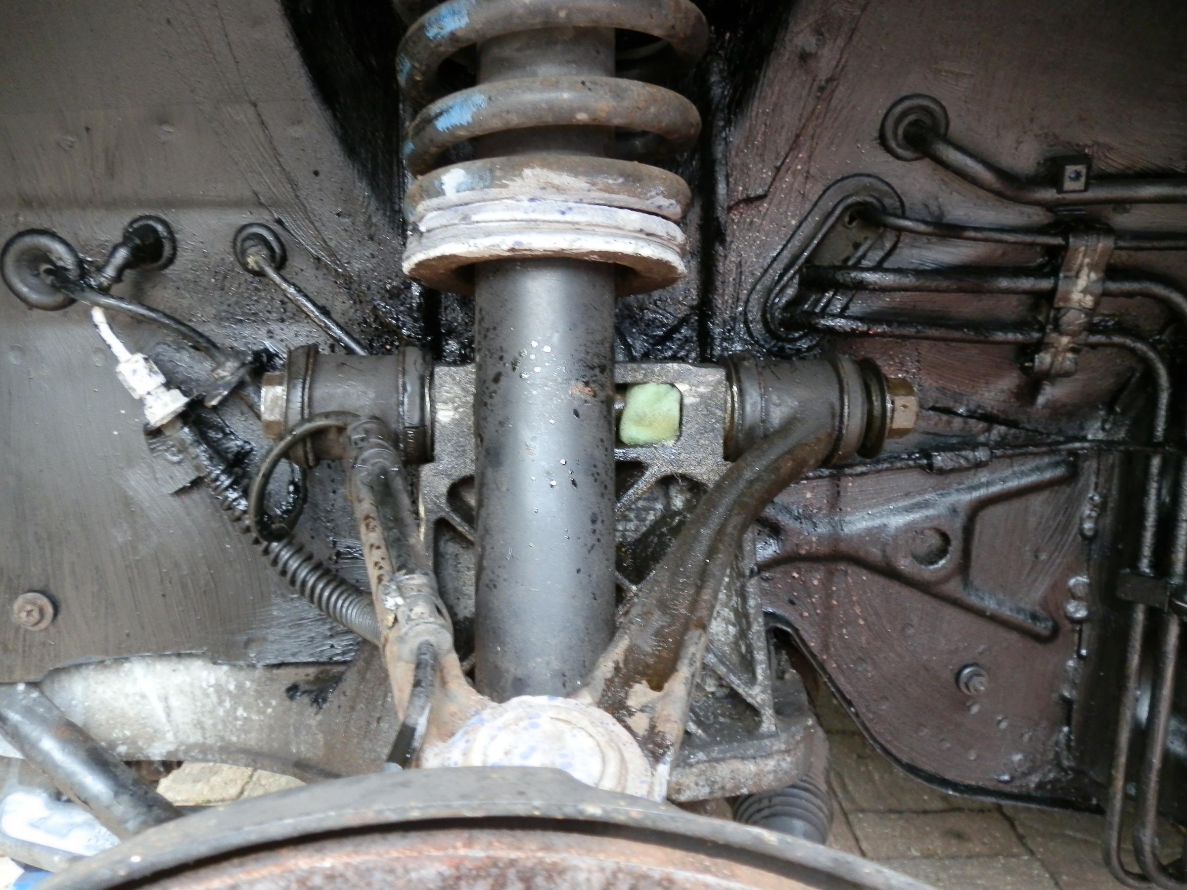

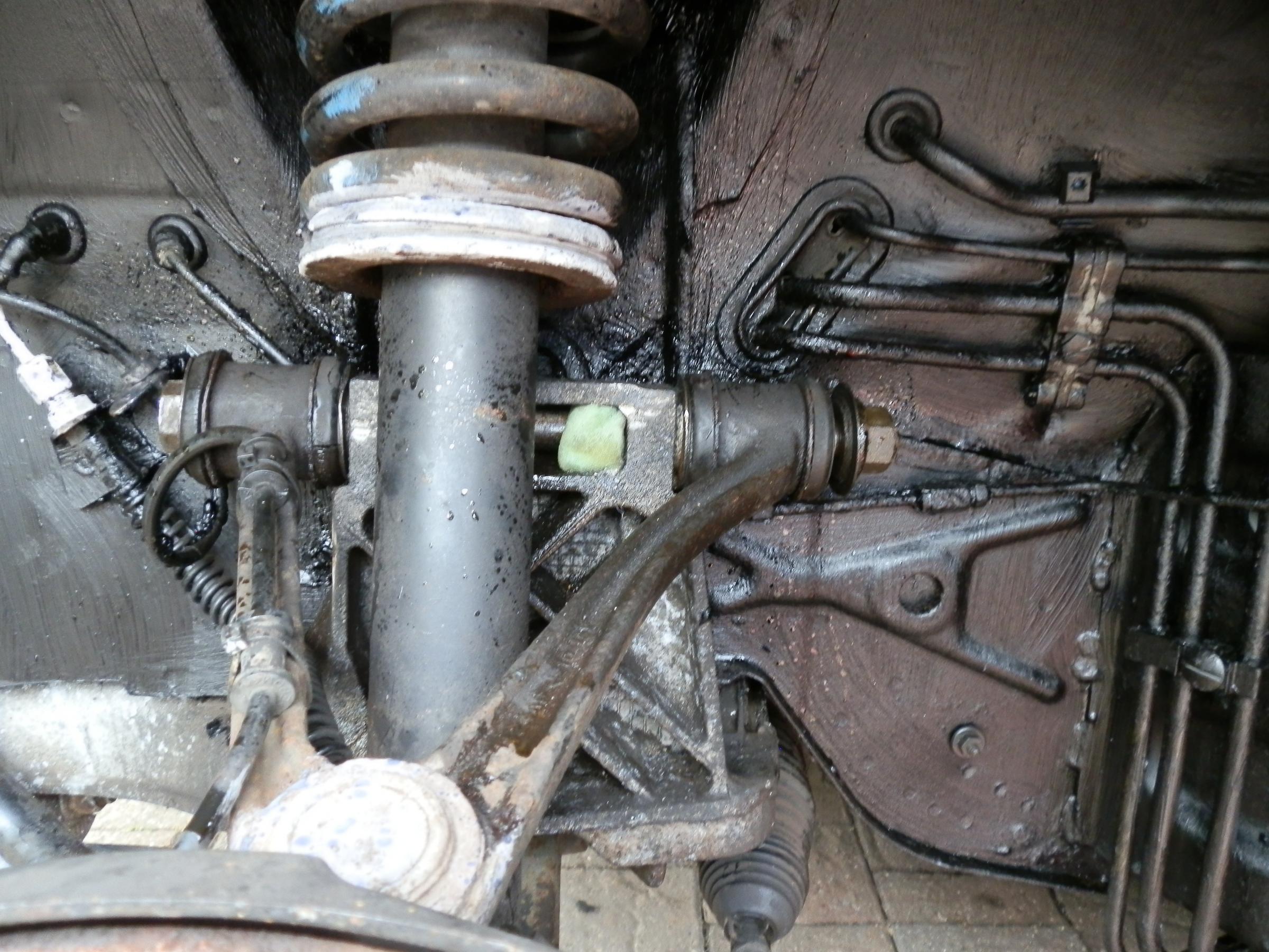

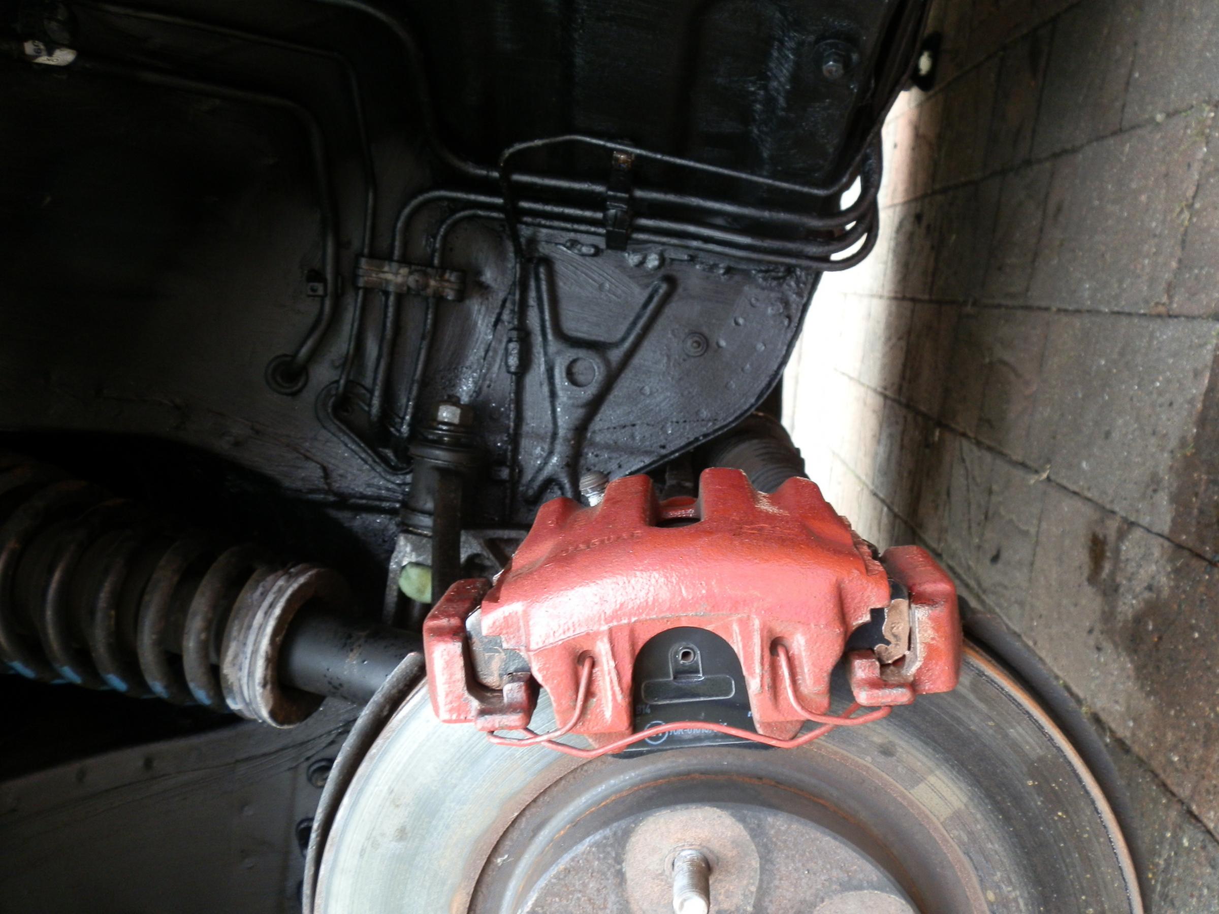

Good morning guys, I am in the middle of this job! Its a real PITA. My bolts are stuck solid! I have had all sorts of penetrating oil in the bolts and washers for a few weeks now, and they are still stuck. The only thing I have not tried is heat. So I booked the car in to my local Indy but he advised me to soak the bolt in coke, he says he uses it regularly to free up rusted in injectors etc ( recommended by Merc dealership ).
I have ordered a recon N/S top arm with balljoint, and bushes/shims/balljoint for the O/S at about a third of the cost. I do not have an impact drill or any other assistance tool like the Rev does in his video. In fact all I have is an adjustable spanner which is flexing when I put the weight on it, I do not know what size the nut/bolt is as non of my sockets or ring/flat spanners go that large. Rev does not stipulate the size of the socket used in his video. he obviously has more tools than I have LOL's . Just out of curiosity could someone tell me what size the bolt is please? The good thing about this job is that I have been able to put some black waxoil paint on the front inner wing sections, and I was very pleased at the condition of the metal work when I was doing the job, very sound for 15 years old.
Any advice/comments greatly appreciated.
Arty

Don't spend any more time trying to get them out, use an angle grinder to cut them off, you can pick up a second hand one for $20.
The bolt was never going to come out of these sleves.
