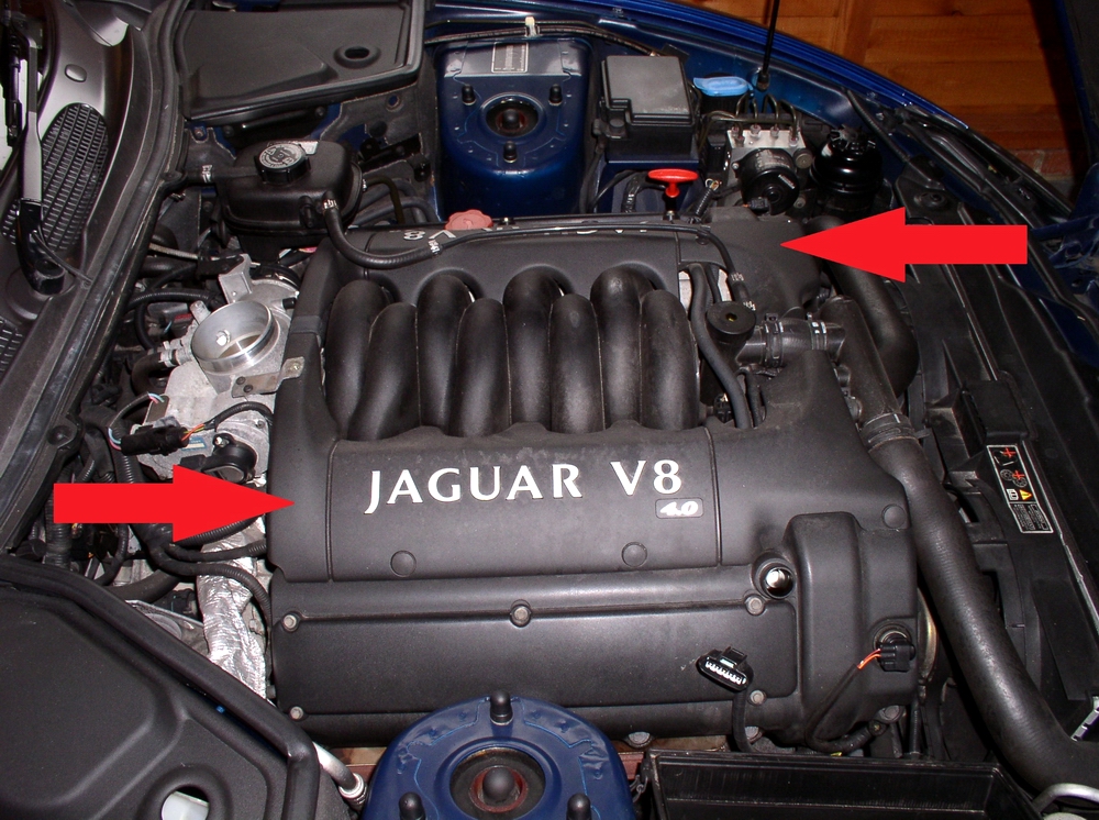

You've discarded the two engine covers (arrowed in red) ........

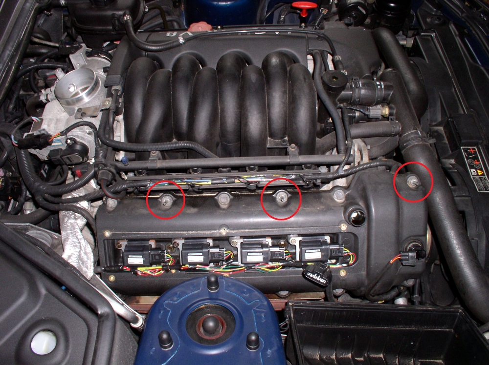

........ they are only secured on three extended bolts (circled in red) with rubber plugs:
You could simply replace the extended bolts with the same standard ones used to secure the other locations in the cam covers.
If you have oiltight cam covers now, consider yourself lucky. Disturbing any of the bolts is likely induce leaks.
