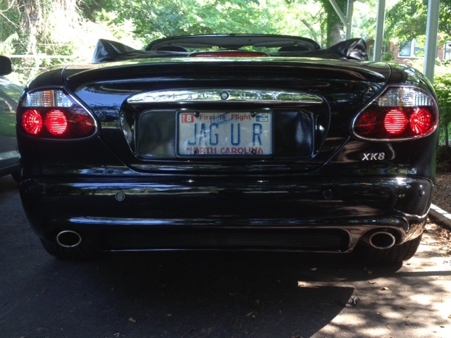

OK!! I never thought it these would make such a difference!! WOW!!!!!!

Originally Posted by philhef
Attachment 48483
Well based on your installed photo I finally bit the bullet and ordered a set of these from Gaudin to be shipped tomorrow. I have gotten to the point where I always expect the worst but then am pleasantly surprised when the worst doesn't happen.
Possible "worst" scenarios are either that the tail lights come but are clear rather than tinted and/or when removing and replacing the tail lights electrical connector falls apart in my hands or some other stupid catastrophe. On the other hand things might go perfectly (crossing my fingers).
Doug
Doug
As long as the part number is correct, you should be fine. I worried about the same thing with the tint/non tint issue. I assumed I would get the wrong ones too!!
As for installing, it couldn't be easier!! My original lights were stuck so it took a firm wack to get them out but they finally released. I also stupidly tried to pull off harness until I realized it takes a simple press of the wire clip and it simply pulls off. Hell, they even come with the bulbs!!
I'm ordering the 06 headlight lenses with the blacked out sections as soon as I can get an 06 vin#. Gaudin says if I have the vin from a car that has the factory black lenses, then I'm assured the correct ones. Mine seem to leak anyway in the rain or wash and I get the misty film inside so I hope this stops that AND gives me a newer look!!
I hope everyone posts pics of their buttlifts!! (Car that is!)
