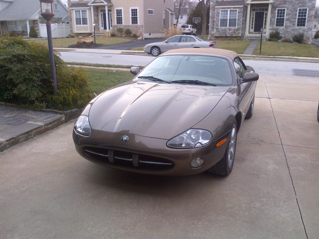

Default Spent a wonderful day working on my XK8
The day started with everyone I went to having the wrong water pump, either rebuilt or made in China. I returned the wrong pump previously mailed to me. I decided to go to Jaguar and buy Name Brand.
Replaced Pump, Thermostat Housing with a alum replacement (Boy the 2 back bolts were a pain in the _ss), and the Thermostat as well as the Upper & Lower Hoses.
Hopefully the cooling system will not need anything for a while.
The fuel rail that runs behind the thermostat housing is very close if not just touching. Has this been a problem?
