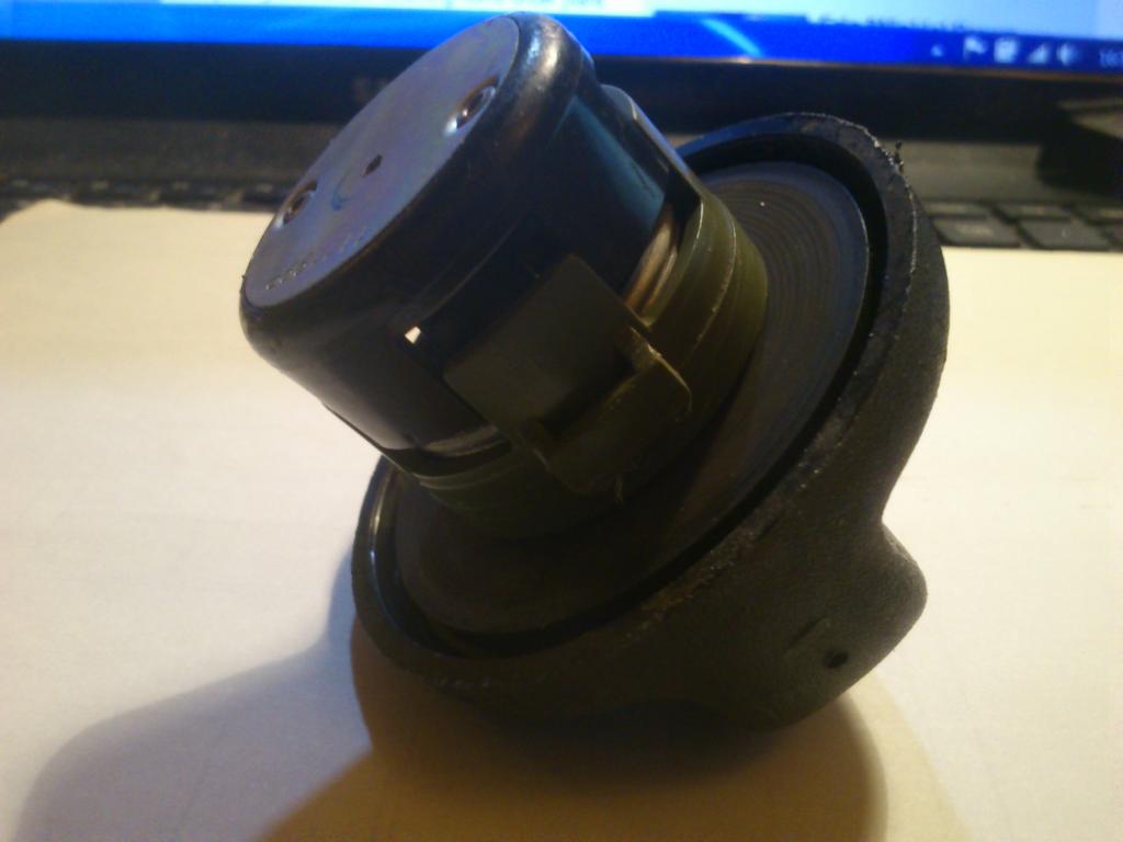

There have been lots of posts about deforming petrol tanks but never any conclusive proof. The NA cars probably have the full vapour recovery system so it's more complex than the UK versions. You can beat it though - don't lock the petrol cap into the bayonet and leave it so it is just sitting in the filler hole. The tank can vent and the noise should stop. Do this as a temporary measure to establish whether it is the tank. A more permanent solution is to drill a tiny hole in the petrol cap so it can vent and never collapse the tank --------->
