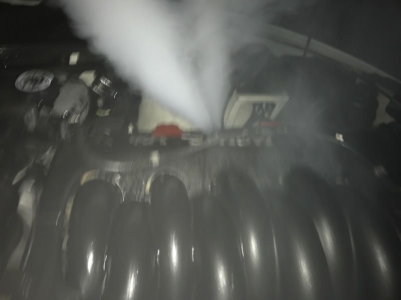

Had a nightmare ride tonight from hell.
Last week, I had both the belt tensioner and belt pulley changed.
So here I am driving home on the turnpike from an appointment, and I hear a "tick tick" as is I ran over asphalt.
Next thing I know, I'm doing 70mph without a serpentine belt, a red-lined temp gauge, and then restricted mode. I had no place to stop.
It started snowing, and my phone was almost dead..
At that point, I decided to absorb my losses and keep going until it dies and blows up.
15 miles with a pinned temp gauge, I make it front of my home, and the little hose coming from the reservoir to the thermostat blows, and steam all over the place.
I shut down and call it a night.
I go back to inspect, and I see a shredded belt, and a melted hose.
