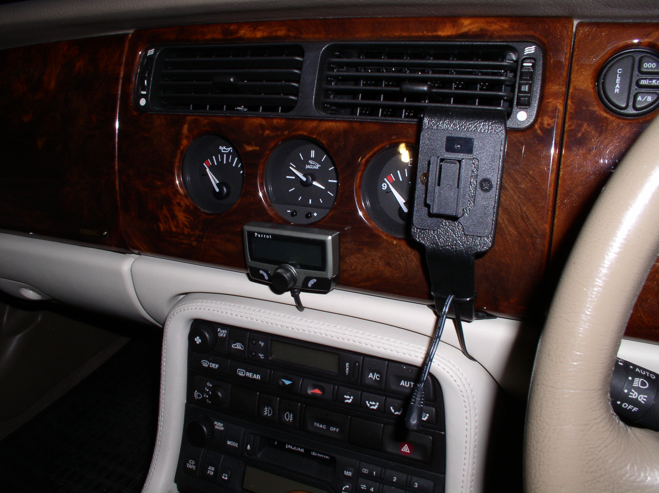

On my 2001, I used the power feed socket for the accessory outlet behind the Glove Box and brought the cables for both Parrot BlueTooth and combined SatNav/Radar Detector out in the gap between the top of the Centre Console and the Dash.
What does everyone do for radar detectors in the XK's-01-brodit-bracket-indago-adaptor.jpg
The bracket is a 'Brodit' with the SatNav mounting clip attached.

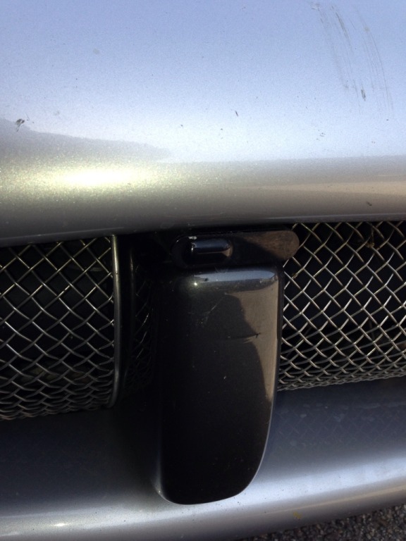

I have a top of the line Escort front and rear system that is permanently installed in the car. The front part hides behind the grill and the rear mounts at the top of the rear license plate. It works great, but today's instant-on radar, typically used in trooper's cars while moving is really stealthy. Any radar detector that goes off as it detects one of those things is just informing you that you are about to get a ticket (if you are speeding). Most motorcycle and stationary police speed traps use laser. I use the Blinder laser jammer and parking assist system. Of course, I only use the laser jammer while driving on private roads. It works! When using a Blinder, you basically CAN'T get a laser based speeding ticket. Of course, if you were to forget that you left the laser jamming system on while driving on a public road, you can quickly switch it over to the parking assist mode for easy parking curb detection. I have the infra red emitters mounted above each front bumper cover as seen here:
