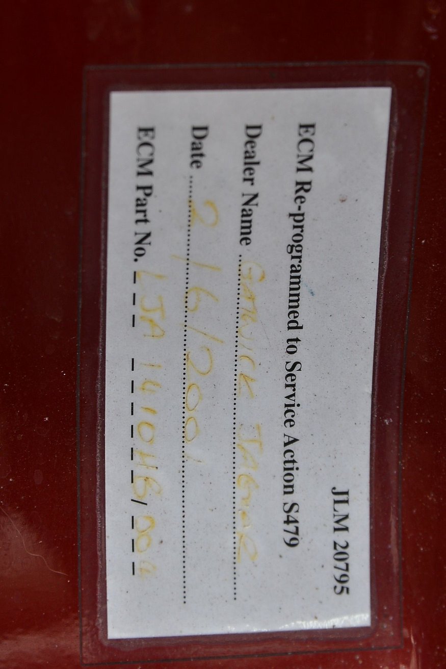

Found on drivers door sill .
Clearly relates to an ECU re-programme but anyone know why it was done and why?

Very likely it is a replacement. The early US models had a capacitor leakage problem that could destroy the circuit board and the same problem may occur in the UK.

See attached TSB 303-35

As always bang on the money. Re programmed to increase the fuel when cranking to aid cold starting . Engine temp measured at the water sender unit . If you have poor cold starting you can fool the computer with a 1000 ohm resistor in series with the sensor and a switch or relay to take it out . This makes computer think the engine is colder than it is. Available as a kit for other JLR vehicles.

will that result in the engine getting more fuel all the time ?
Z
Old Feb 13, 2022 | 07:06 AM
mcook's Avatar
Posts: 143
Likes: 30
From: Ellijay, Georgia
As mentioned, you would need a switch or relay to short out the resistor.
Old Feb 13, 2022 | 08:57 AM
Pistnbroke's Avatar
Joined: Mar 2021
Posts: 2,147
Likes: 897
From: Northampton, UK
The kits on ebay were for LR P38 diesels which had a cold start problem when the pump was worn. When the ignition was turned on a relay with a 20 sec timer was activated and at the end of the timer period the resistor was bypassed . Lots of timers on ebay for about $5 I have one to turn my SRS light off !!!!
