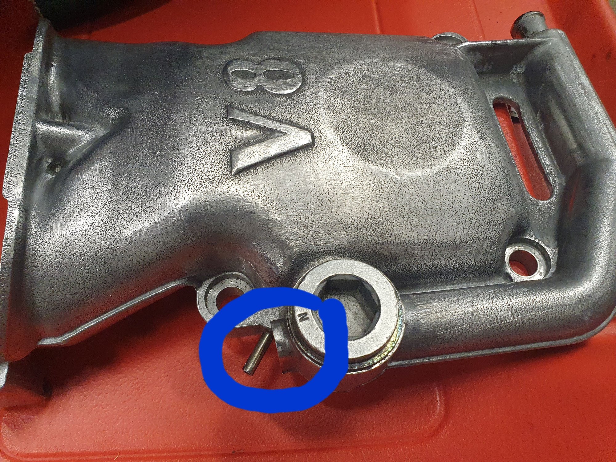

Hi,
progress is slooooow reassembling my Xkr. Vacation is soon here and fiance is not signalling happiness at the prospect of me spending time in the garage..
So just a brief moment here and there with the jag. Being 1.5 years since tearing everything apart I have forgot what tube goes into the supercharger plenum. Is it a vacuum hose?

Correct. It goes to the fuel pressure regulator or fuel pressure sensor depending what year the car is (4.0 or 4.2L).

Thank you Charles! Helpful as always, you're always to count on
