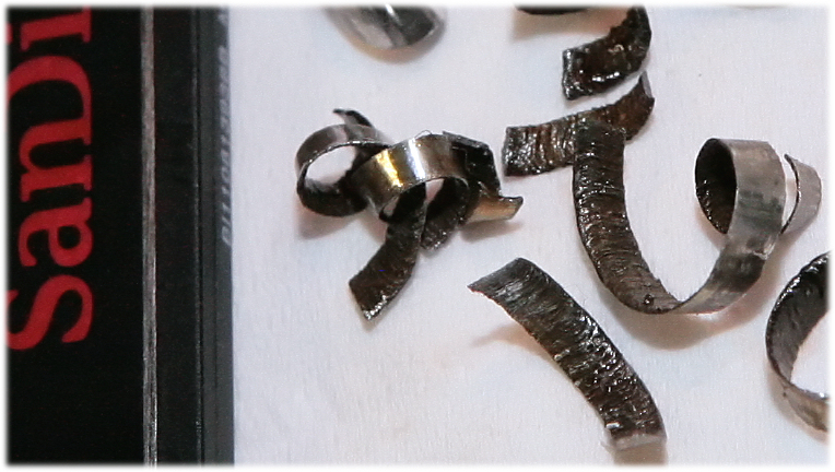

Originally Posted by heima
Can somebody explain to me why one side of the shavings are pristine clean, and the other side are stained of different degree? For example: Bottom right, dark. Middle, in between. Upper left, light. Bottom left, none. If these shavings were assumed to be clean at the factory, and they have been sitting in the sump for all this time, should they not be equally discolored, if at all?
Looking at the underside of the crankcase in the first photo, how there is a gradient of discoloration, makes me think the way I do.
I am guessing that the rough, discolored side is the raw casting side, and the other side is smooth and shiny as it is the side that was shaved by whatever tool was used. Since that side is so smooth, the oil does not stick to it as it does to the rough side.

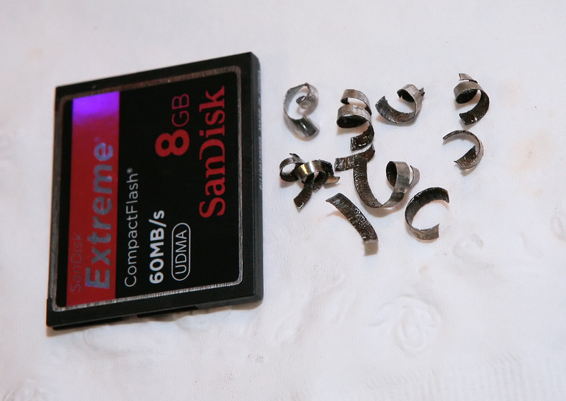

Pics as promised, scale reference was my CF card from my dslr.
Attached Thumbnails What the heck was in my oil pan! And HOW did it get there?!?-p1371570902-4.jpg   What the heck was in my oil pan! And HOW did it get there?!?-p1371570932.jpg

Old 01-09-2013, 08:02 AM
Gus's Avatar
Gus
Gus is online now
Join Date: Jul 2008
Location: Berlin Md.
Posts: 11,341
Received 2,207 Likes on 1,700 Posts
The shavings look like they came from a surface cut and not an internal drilling. Measure the width of the remnants and best guess on the length and that might give you direction.

Received 77 Likes on 57 Posts
The grave situation would be a spun bearing. Haven't heard of (m)any of those on the forum. I am not saying it is but the things that would make me want to investigate: A) those shavings seem to come from a piece that was initially fixed somewhere and exposed to heat AND oil before they were removed (something cooked on one side). If they were there from the creation of the block I would think they would have the same appearance on both sides (as others have hinted or questioned). B) The dimension appears to be about the normal width of a bearing tab? C) The "grooving" nature of the chips as XKRacer described D) Your noise. Odds are it isn't but I am a consummate paranoid and tend to think of the worst scenario and then work my way back to, "Oh I just need air in the tire".

Received 21 Likes on 9 Posts
Is it just me or can everyone else see the small bit still stuck in between the oil pick up screen and the snout?
I wonder how the pieces got in there? how may miles have rolled on past with no problems? If I was a gambling man (and I am) i'd be putting it back together and run it. Get it out of my mind and don't look back till you hear the screaming and screetching right before the boom from under the hood.

Matt,
I just realized that my post this AM was poorly worded and probably misleading.
I wasn't suggesting you get an oil analysis, but the guys who do those have equipment to measure the concentrations of various metals in a fluid, and they could surely tell you what your metal bits are made of.
This would seem to me a very good thing to know. If it's material used to make bearings, that's ugly, but if it's the material used to make the oil pan, you're probably in the clear.

Posts: 619
Received 208 Likes on 151 Posts
I know those shavings! I've seen them many times. Every time I pulled an oil pan down, those shavings were in the screen. I would not worry about it. I guess the cleansing process for the blocks was less than perfect. Heck, it could still be, I have a 5.0 opened up at work, I'll take a look at the pickup screen and report back.
Those are most definitely from the initial block machining. They got washed out in the oil passages and ended up in the sump screen. Consider this, if those were damaging shavings, then you would HEAR something different.

Originally Posted by BlackX300VDP
I know those shavings! I've seen them many times. Every time I pulled an oil pan down, those shavings were in the screen. <snip>
And there you have it, mystery solved! I was hoping a jagtech would stop by to confirm other sightings.

Received 324 Likes on 276 Posts
Those cuttings were made by a milling machine operation on the block. The cutter was a flat one of the same width as the cutting, and hard to say which area it was working in. Judging from the average length of the cuttings, the cutter was machining a hole the circumference of the cutting length. If I had to guess, it was the openings for the cooling system, water pump, etc.
