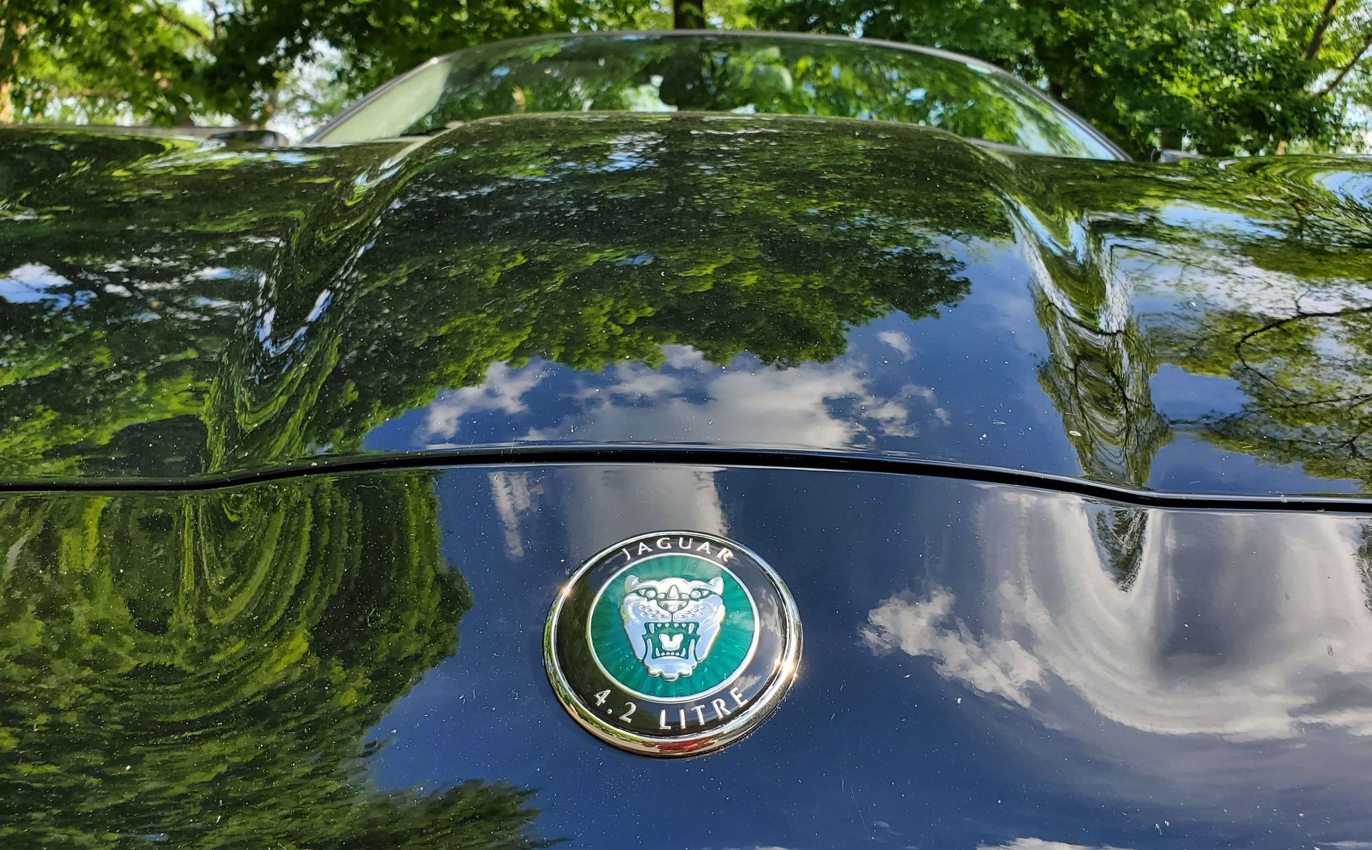

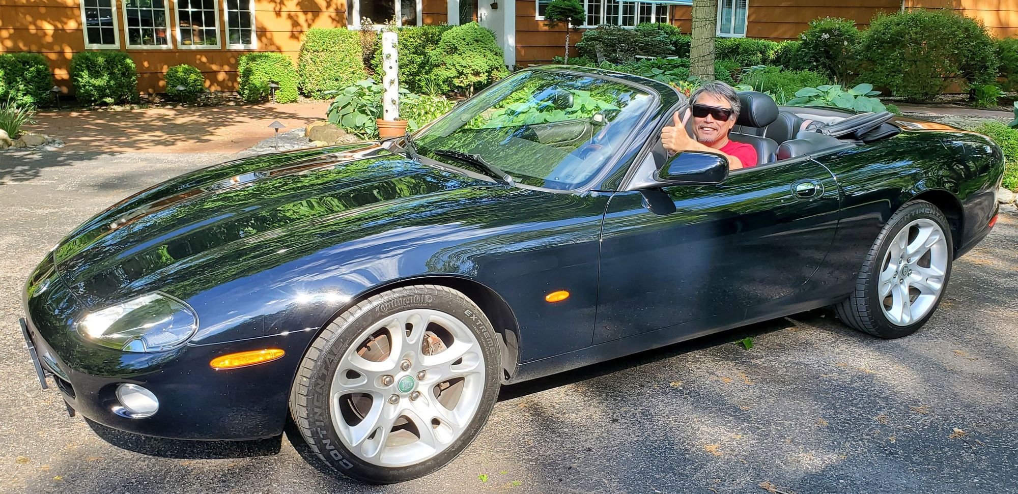

Bought it. In my newbie enthusiasm I upload some phone shots after the short trip to my driveway. Pardon me if that is not the culture in this forum. Next step is insurance, should it be Nationwide or Hegarty?

The car looks great bud. They all have a little something that they need done.
I hope you have many years of fun and trouble free driving. Cheers.

Looking good!
FWIW Hagerty would not insure mine - I drive it too much.
