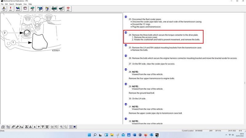

On the bottom of the torque converter housing there is (or in my case, was) a plastic cover shown in
the parts list as
NJA 4465 AA Stoneguard Gearbox Torque Converter Housing Solid.
Is this a cover for an inspection port or what? I'm not sure why there is an opening in the housing.
Old Jan 24, 2022 | 02:22 AM
Likes: 17,009
You'll find out if you ever need to take the transmission off. It's the way to access the Torque Converter bolts:
