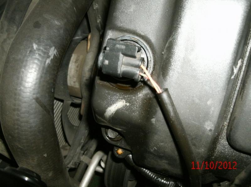

I noticed last week while in traffic that there was slight smoke coming from the engine. I didn't think much of it because I had not driven it for a few days and maybe there was a bit of oil leaked. I had the tensioners and the seals replaced about 6 months ago as well.
When I went to check it out I noticed a sensor that mounts right next to the oil dipstick. I've included a picture of it. This is leaking oil and needs to be resealed I think. If anyone can tell me what it is and how to get it fixed let me know. I think the shop that replaced the seals would still be responsible for sealing this right?

Variable camshaft timing oil control solenoid electrical connector.
There's a circular seal between it and the Camshaft Cover. Provided the sensor hasn't broken or come loose, it's likely to be the seal that's failed.

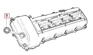

Here's the seal (item 9) in the Parts Manual drawing:
Part Number AJ82856

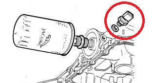

No - you'd get a low pressure light if the Oil Pressure Sensor (circled in red) next to the Oil Filter was faulty:
Is the Cam Cover sensor pouring oil out or is it a slight drip and perhaps some smoke if it drips onto the hot exhaust?

It's seeping out and probably dripped, it's no gusher but I do want to get it fixed. Is there any sort of guide on how to do this?
For instance do I need to remove the cover to do this or can I just disengage the solenoid and twist it out and install the new seal?

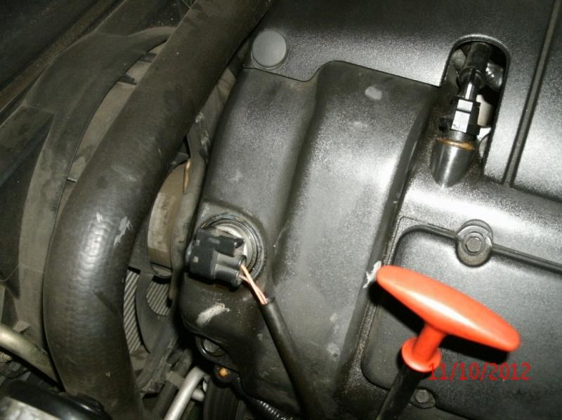

Here is a pic I just took.

Old Nov 10, 2012 | 08:49 PM
WhiteXKR's Avatar
Joined: Apr 2010
Posts: 7,657
Likes: 3,021
From: Arlington VA USA
As Graham, said, it is the VVT solenoid seal. This is super easy to replace. Depress the connector tab and unplug the connector. Clean the sensor body. Then using a small flat blade screwdriver simply pry the seal up, working your way around a little at a time. Press the new one in evenly and reconnect the cable.
Thats it. AJ82856 is 20 bucks at Gaudin, probably around $27 at your local dealer.

See from your new pictures that I was wrong. GGG and whiteXKR are right.
