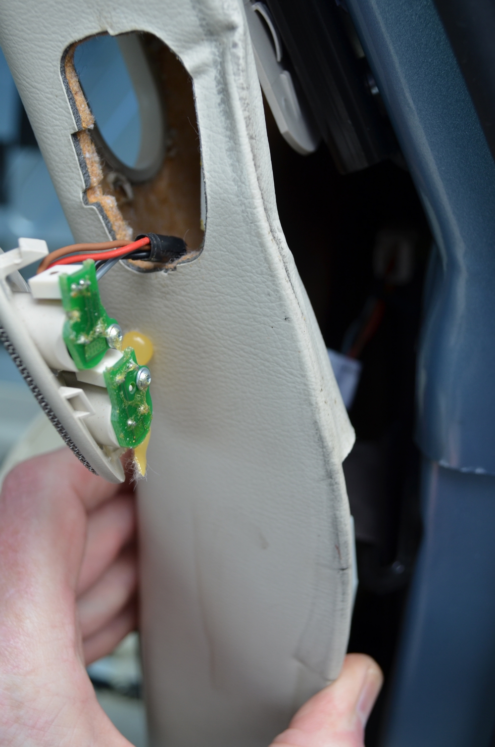

Here is the passenger one removed from my 2005 XK8 when I was having SRS (Supplementary Restraint System) issues with a permanent Airbag warning illuminated.
Turned out to be a fried module and not one of the occupancy sensors.
