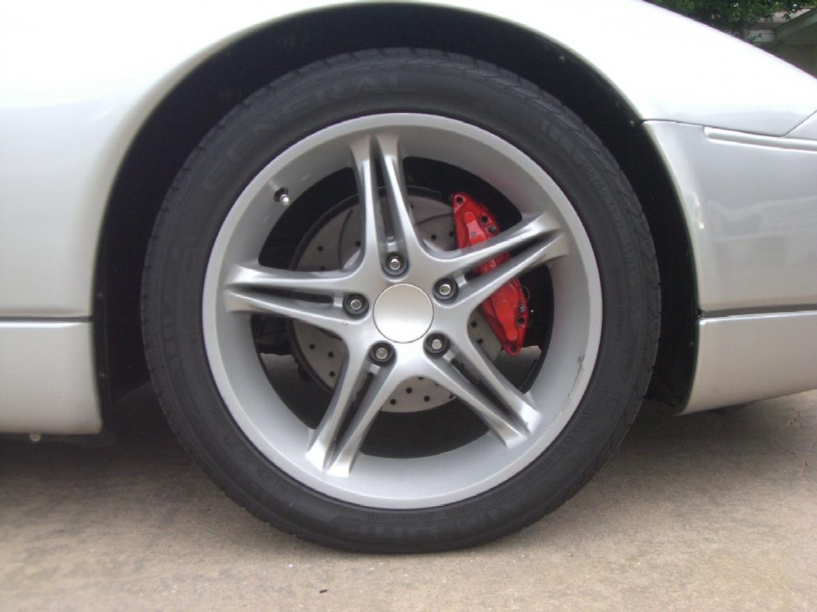

I had a set of wheels for my 300ZX powder-coated silver. Cost was $200.
