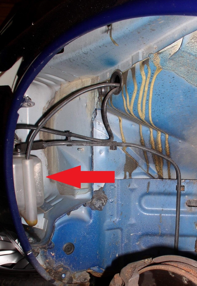

I'm trying to work out what side is 'passenger' side in Puerto Rico but can't make it out in your Avatar.
I'll guess it's the RH. If I'm right, you could have a leak from the Atmospheric Recovery Bottle or one of the pipes to it.
The liner has to be removed to access the Atmospheric Recovery Bottle.

The pipe from the Expansion Tank or the Bottle cap can become detached which are both easy to see. I can't recall reports on the forum of anyone having an instance of the Bottle splitting.
