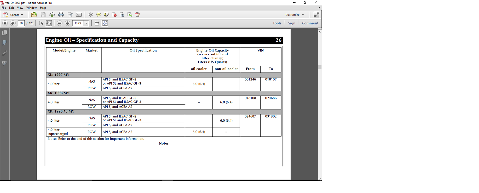

Isn't it 6L 6.4Qts?
Did you lift the car at the rear to help draining? Some do I don't.
If you are good on the dipstick you will be fine.

My "Vehicle Care" booklet (JJM 10 16 14/72) for my 1997 4.0 car says :
Engine oil capacity - with oil cooler = 7.3l and without oil cooler 6.5l
I assume the booklet gives total capacity, rather than the amount that is likely to drain out when doing an oil-change.
