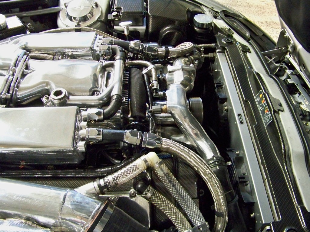

Hydrographics looks more realistic than wrapping but at close scrutiny you can still tell
You spray activator only where you want the graphics to stick so mask up and spray, remove the tape, dip, wash off then clear coat, sounds easy but trust me there is a knack

Looks good. Thought of getting bits chromed but that looks good too. Perhaps more in keeping with the car?

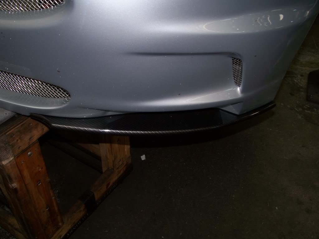

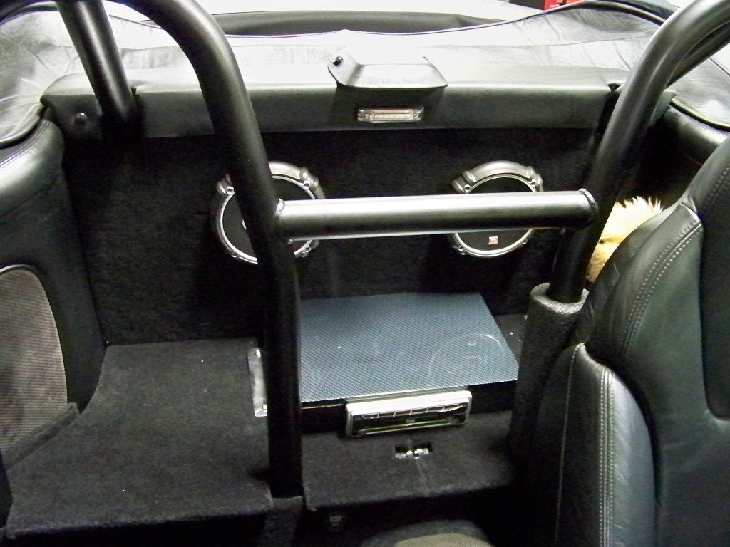

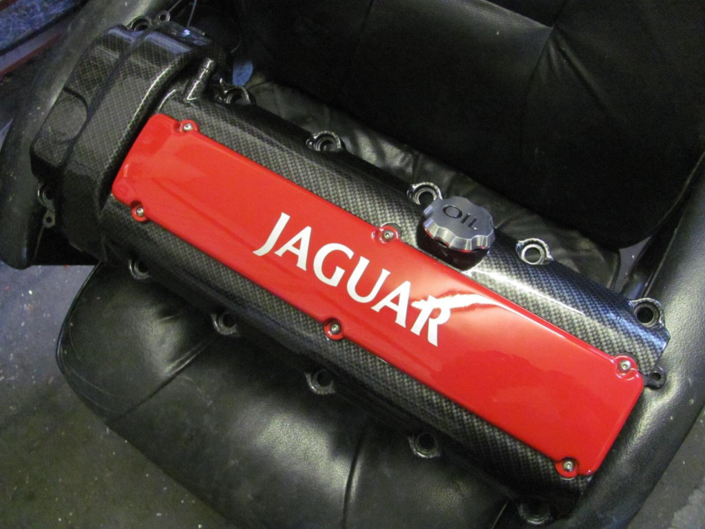

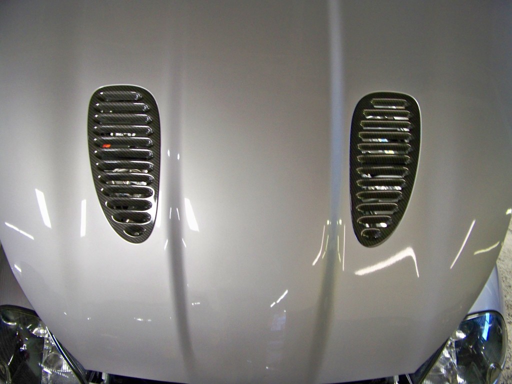

This is all Hydrographics.
