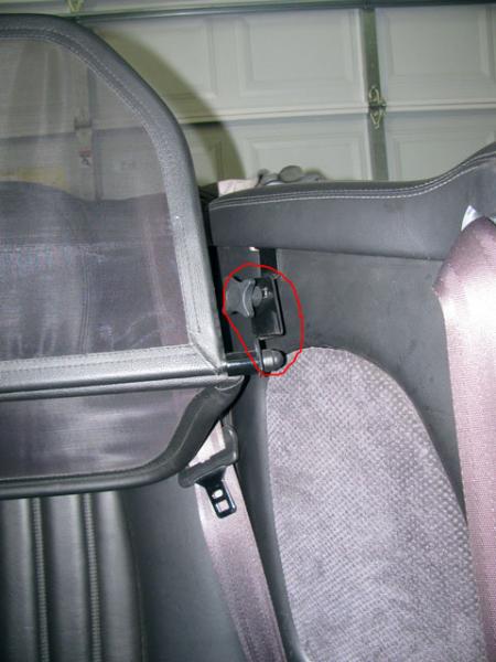

What brand did you install? The one I installed was too tall for my taste, so I moved the left bracket to the right and vice-versa, which meant each bracket had to be installed upside down. That lowered the top of the deflector by about 2-3 inches. I think it looks much better like that. Before, it was actually sticking up into the wind. The wind coming over the windshield would hit the top of it and get deflected down into the car.
Look at this pic. The passenger side headrest is all the way up, and the driver's side is all the way down. This is with the brackets reversed so the deflector sits lower. I think I installed the Welsh deflector. Or maybe it's Adamesh. I forget. It came from the UK. If you installed the same one, maybe you accidentally got the brackets reversed.

Here's a picture of my bracket. The thing circled in red is the part I reversed. It is bolted to the actual deflector, not the brackets that bolt to the car. The brackets that bolt to the car have to angle downward. The deflector has two mesh pieces. As you can see in the pic below, my lower mesh piece is very low. It's supposed to be even with the top of the seat back. Because I reversed the brackets, the lower mesh piece doesn't sit horizontally like it's supposed to. Also, the bar across the top slightly blocks my view in the rear view mirror. To me that's preferable to having the deflector stick way up and detract from the beauty of the car.

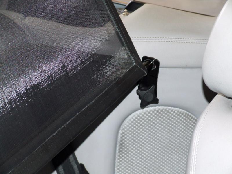

Just installed one of the deflectors sold by Welsh. Installation was not bad but their instructions are almost a hindrance.
An observation: there is no way that the normal position for this deflector ends up vertical. Rather it will naturally want to slope back a bid until stopped by the horizontal piece bearing against the seat back. If I do want to try and force it to be vertical I would have to really tighten up the bolts that hold the larger piece to the bracket and that would prevent the deflector from rotating down when not in use.

Attached Thumbnails Wind Deflector-deflector.jpg   Wind Deflector-bracket1.jpg   Wind Deflector-bracket2.jpg
