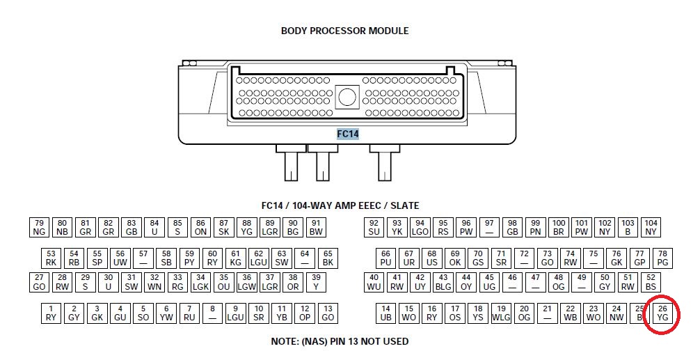

I don't know how easy it is to get to the large connector FC14, but you're looking for the yellow/green wire on pin 26 of that connector (see attached).
Normally, there should be little to no voltage on that pin. Press the stalk button (ignition in position II) and you should see a rise to around 12 volts until the button is released.
If so, then you'll need to trace that yellow/green wire through harness connector LF1 to where it meets the pump under the wheel arch. JTIS shows that as being a 20-way, slate coloured connector and located "LEFT HAND 'A' POST CONNECTOR MOUNTING BRACKET/'A' POST TRIM" (not entirely helpful)
If not, then we need to determine why the BPM isn't supplying power: either a fault with the module itself or one of the power feeds to it, although in the latter case I'd expect to see other issues.
