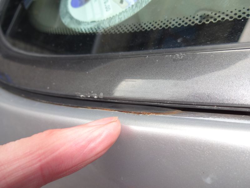

Guys, I want to do something about this rust, can anyone explain how to get the window trim off so I can get to the problem area.

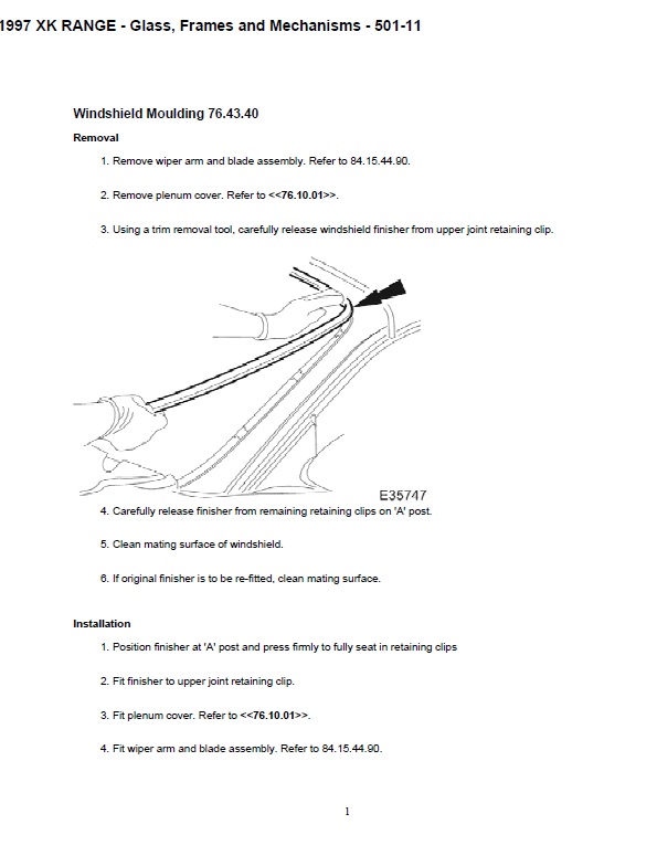

+1
The procedure in the Jaguar Bodyshop Manual for removing the windscreen trim sounds so easy but I've seen several trims damaged by incorrect removal or refitting.
Even if you do take the trims off, it doesn't get you much better access to the problem area because the rubber is still in the way.
I've had a windscreen taken out of an XJ8 for the same reason. However, as it was a bonded screen, the work was done at my risk owing to the chance of breakage. The fitter was skillful and I was lucky so the screen came out and went back in after the rust repair. The XK8 is bonded in the same way. If you choose this approach, be prepared for the possibility of the windscreen breaking during removal.

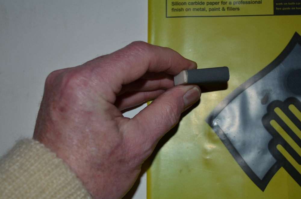

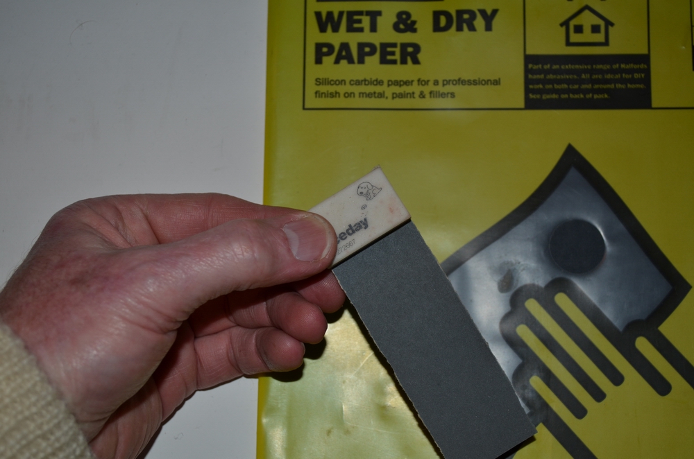

Masking up the body and glass looks straightforward but rubbing down needs precision.
When I did my Door Waist trims, I found using a pencil eraser as a miniature rubbing block made accurate work much easier:
1. prepare strips of 1200 grit West & Dry the same width as the eraser
2. wrap the Wet & Dry around the eraser
3. use the narrow edge which is approximately one third of the width of the trim
This enabled me to get right to the edge of the trim without damaging the rubber moulding.

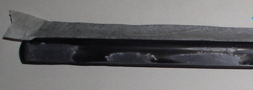

I need to do my door trims as well and I have experimented in taking the trims off, which I have managed easily as well as re fitting them.
The main problem I have is that the aluminium is oxidising on the underside, where it is bonded to the rubber seal and as a consequence, it is pushing the trim piece ends upwards, away from the seal. The only way I can see to sort this out is to remove the trims from the doors, separate the trim from the seal, prepare and paint the trim and then attempt to re bond the two pieces together. Do you have any experience or thoughts on this?

Old May 18, 2013 | 02:10 PM
Do they look like this one?
I thought this was completely gone but was surprised to find it cleaned up and refinished successfully. The main problem is the rubber seal can't be separated from the trim to refurbish them.
Over a year later and it's still unmarked.
The problem with both the early grey trims and later black trims is poor priming. Thorough preparation and etch priming is required.

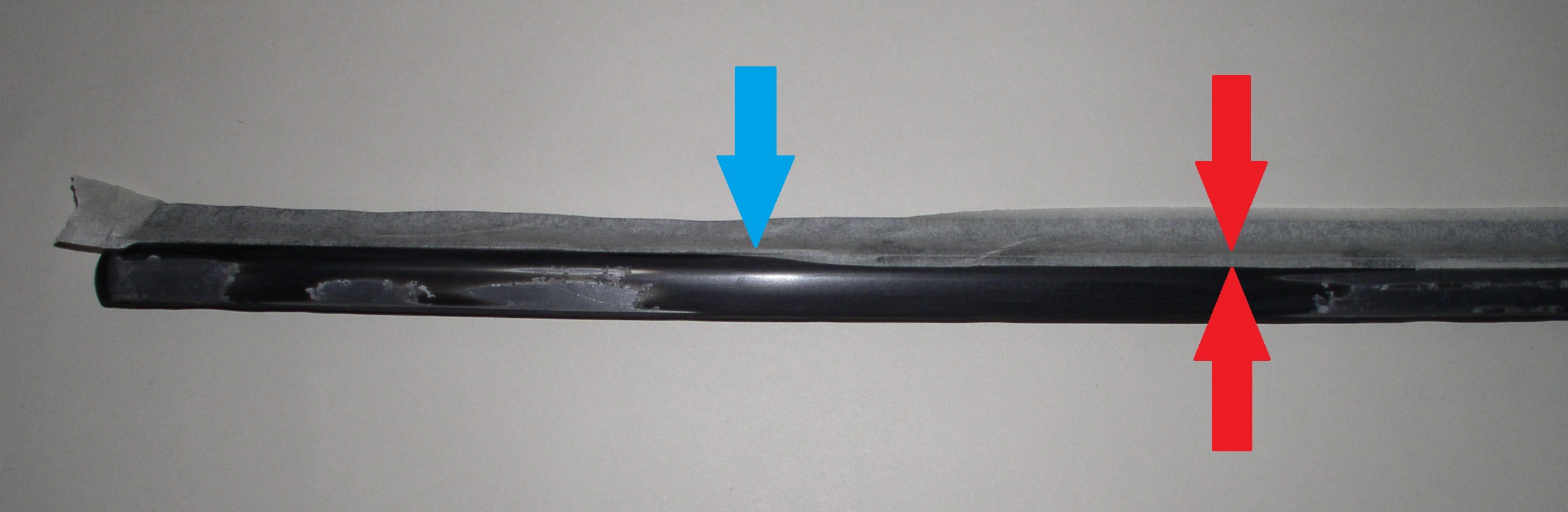

Mine has similar white powder but cleaned up successfully.
The trim seems to be pressed around the rubber seal with no way of dismantling it. If you cut it, there's little chance of being able to glue back such thin edges.
Careful masking avoids the need for this:
Apply masking tape overlapping the trim by approximately 3mm as shown by the two red arrows.
Pull the rubber seal away from the trim and turn the masking tape under the edge (as shown from the left up to the blue arrow) using a credit card or similar thin plastic.
Continue this folding along the full length and repeat for the other edge of the trim.

Two years on and I have finally got round to this.
I used this trim tool to ease off the trim starting at the bottom.
A closer look at the problem area.
A little bit of sanding.
A lot of rust eater, reapplied at least 6 times over 6 hours, with a lot of agitation with a sharp pick.
Not perfect but good enough for some epoxy primer.
