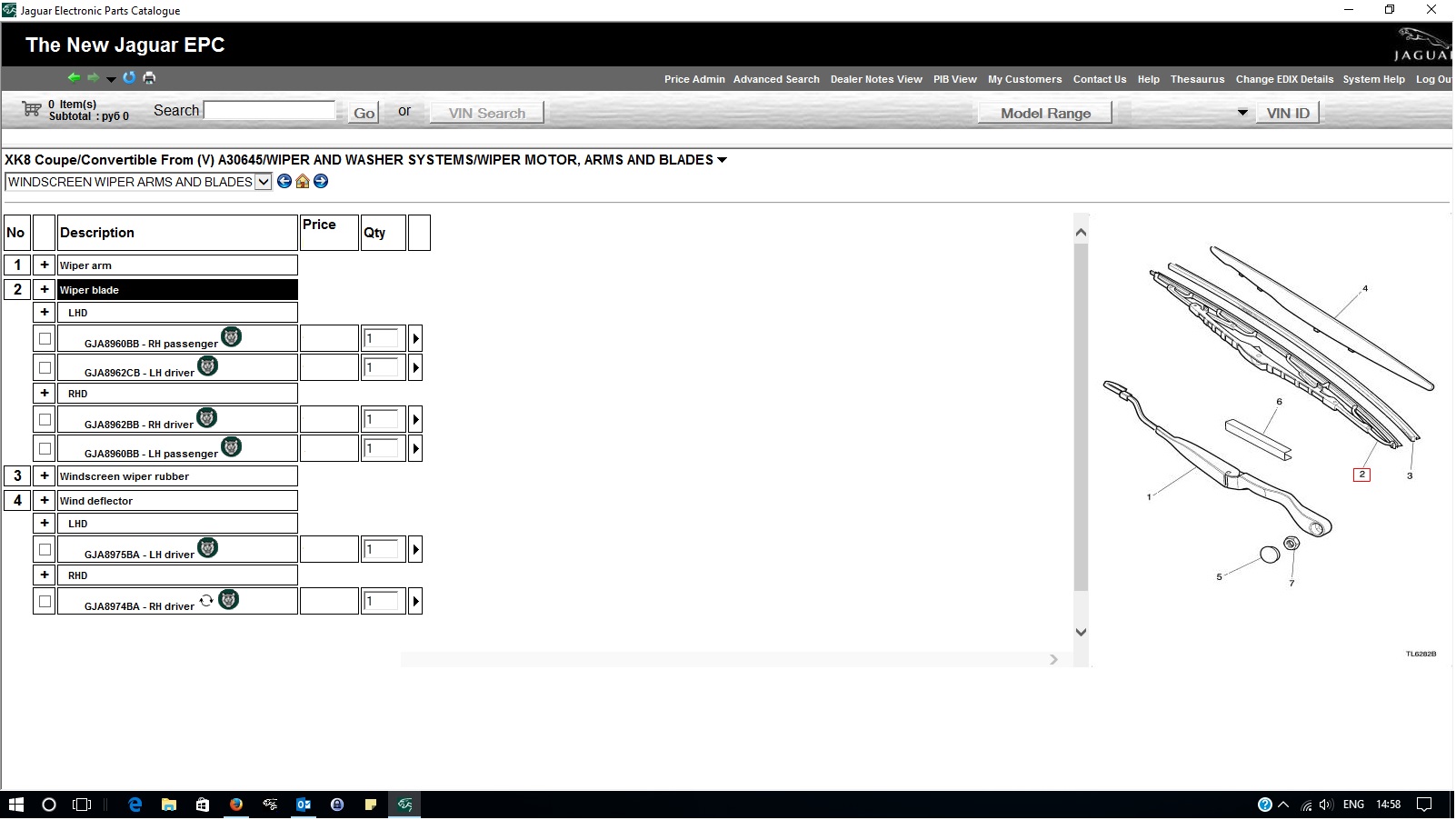

Old Aug 15, 2017 | 09:03 AM
JEPC shows the Wiper Blade and Wind Deflector are supplied separately:
I changed blades on my 2005 XK8 but re-used the deflctor.
