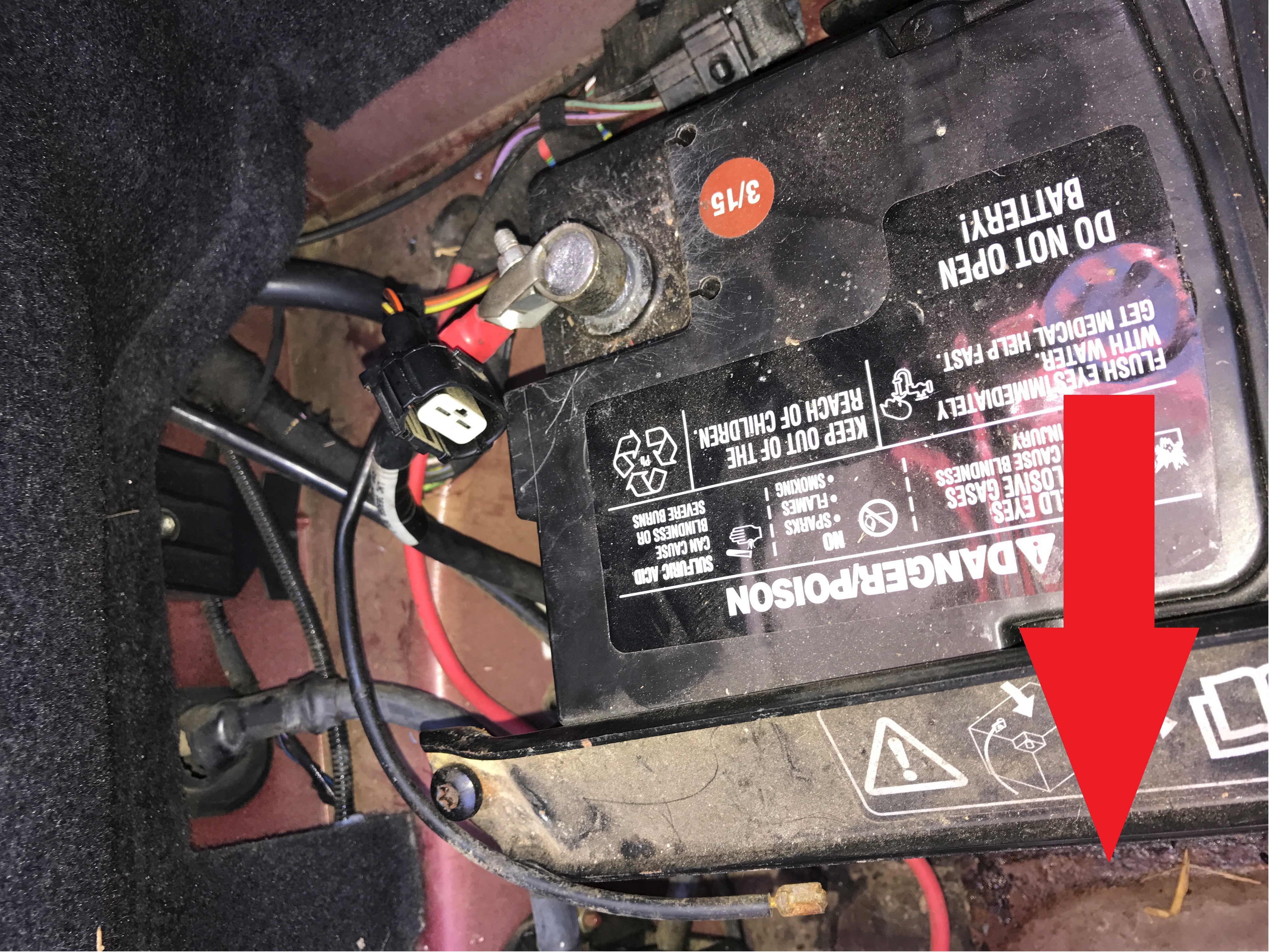

Can someone tell me what this plug is for and the black wire with connector on it?

Nothing to worry about Dale, it is the " in transit system " used to keep the car powered up when first delivered from manufacturer to the dealer. The relay used will also have been removed and that plug is now redundant.

Originally Posted by jimbov8
Nothing to worry about Dale .......
Unlike THIS - RUST UNDER THE BATTERY.
Now that IS something to worry about.

Good spot Graham, needs a bit of TLC I fear.

Thanks to both of you. I'll pull battery and have another look.
