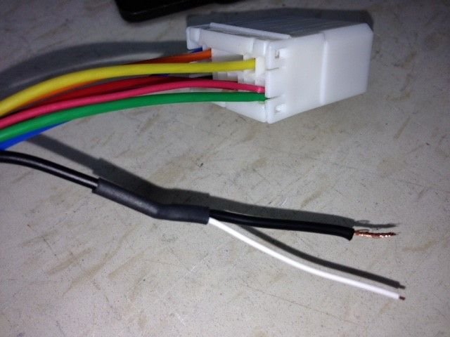

I decided to use the existing wiring in the car for the overhead mic; this meant that I had to re-terminate the mic cable coming out of the 605 into the connector (pin 4 mic+, pin 5 mic -). This photo is of the mic cable stripped back, and the shield twisted:
I then covered the shield with Alpha FIT shrink tubing, and slid a larger piece of shrink down on to the end of the external sheath to clean up the strip-back:
