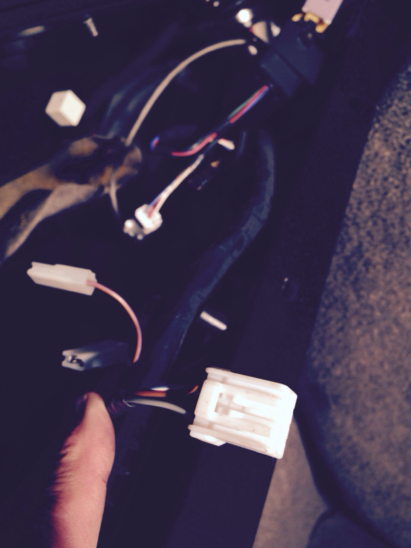

I was doing some work on my antislosh module and I happened upon an electrical connector with nothing connected to it. The connector comes out of the harness directly above the CD changer. The wires are Black, Gray, white/blue, red/brownish orange. Anyone know what this should be hooked up to. Thanks.

There is an ALBS diagnostic socket in the left hand side of the trunk. In my 1990, 3.6 it is a 3 socket set up but on later cars I think it may be 4 (see a post I started on ALBS warning lights). Might possibly be this, others may know better. Regards LeeP

Jaguar ABS Here is a site that explains your plug...
