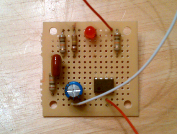

Well, it's been three days. As long as I remember to push the button for 7 or 8 seconds the car will start instantly! I'm soldering myself a little timer board and I'm going to tie it into the interior lights. When I open the door the interior lights will come on. When they come on they will activate the timer for 8 seconds. The pump will run and charge up the fuel system. By the time I'm seated and ready to start the car the fuel system will be fully charged and ready to go. I won't even have to think about this problem any more.
One of these days my fuel pump will finally quit on me. When that happens I'll remove my Rube Goldberg device.

To continue... I built myself a little circuit board with a 555 timer chip, a few resistors, and a couple of capacitors. It's only about 2 inches square, and I'm going to install it with the relay in the trunk near the fuel pump module. I have it set up so that when I trigger the timer it will hold the relay on for 10 seconds. I'm going to trigger the timer with the same wire that activates the dome light when the door is opened. That way, when I open the door, the timer will come on for ten seconds and pre-charge the fuel system. By the time I turn the key it should crank right up.
Anyway... here's my little timer:
The LED is just so that I could verify that it was working properly. It isn't really necessary. Ignore the little scorch mark. It's been a while since I've done any PCB soldering. The white wire gets connected to the chassis ground. One red wire will connect to the dome light circuit and that will activate the timer. The other red wire will be the output to turn on the relay. When the timer runs out that second red wire will turn off and the relay will go back to the "normal" condition.
