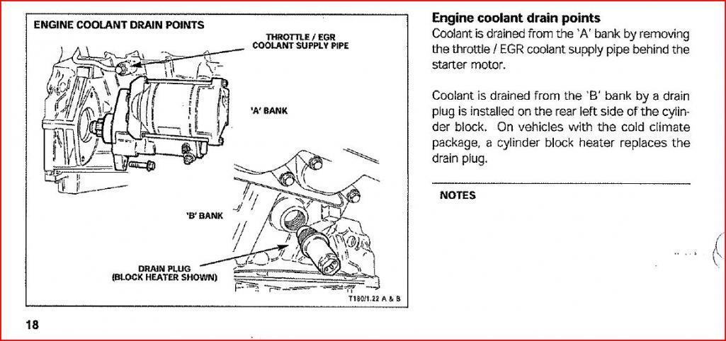

Did not want to leave it any longer so going to flush and fill with correct coolant. I am worried about the yellow DOW S542 coolant mixing with the dexcool to create a sludge as I am confident the dealer just did a drain and re-fill. My plan is to run the engine at 1500-2000 RPM until temperature gauge reads in the center mark and the electric radiator fans starts operating. Then switch on climate control to max fan and max temperature and run for about 10 more minutes. I will do this twice with distilled water. However I understand that even with the drain plug removed on the radiator there is sill coolant remaining in the engine. My question is how can I be sure to get all of the dexcool out of my engine?

Here are the drain points on each side of the engine:
