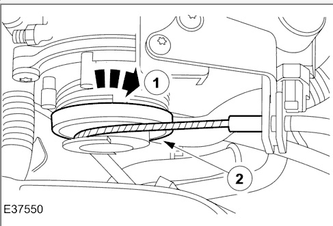

Have you checked that the throttle cable is adjusted properly? You can use a suitable OBD reader to see if you are getting 100℅ open throttle when the pedal is all the way down. If not, it is an easy fix.

The damage to the TB sounds as if it could explain the lack of power but an incorrectly adjusted throttle cable not allowing the throttle butterfly to fully open is often a cause of poor performance.

Hi i have adjusted throttel cable to max without affecting the idle speed still no improve ment
