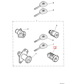

Default Here are the pics
I attached 3 pics from the Jaguar parts software, I don't see the ring, please point it out...
Attached Thumbnails XK8 2001 won't start after a short drive-9-6-2015-9-49-12-am.jpg   XK8 2001 won't start after a short drive-9-6-2015-9-49-34-am.jpg   XK8 2001 won't start after a short drive-9-6-2015-9-50-04-am.jpg
I believe it is the item I've highlighted in green. Not numbered ( above #8).

The is all one part called the Illumination control switch:
Jaguar ILLUMINATION CONTROL DIMMER SWITCH - LJA6500AB
Maybe Richxk8 can tell us what part number he bought

The part # is - LJA2668AB COIL-K $26.15 @ Jaguar dealer

Yup I finally found it hidden in the parts listings. It was listed with the security system parts. I sell it for $30.07. Thanks Richxk8 it was driving me crazy that I couldn't find it!

The part # is LJA 2668AB, COIL-K, $26.15 at the dealer.
Fairly easy to install, two screws in the bottom column cover and three in the top cover, from the under side, tilt wheel all the way up to do them. Ring just snaps on the key barrel and then route the wire back up to the plug. The item circled in the picture is what you are looking for.
