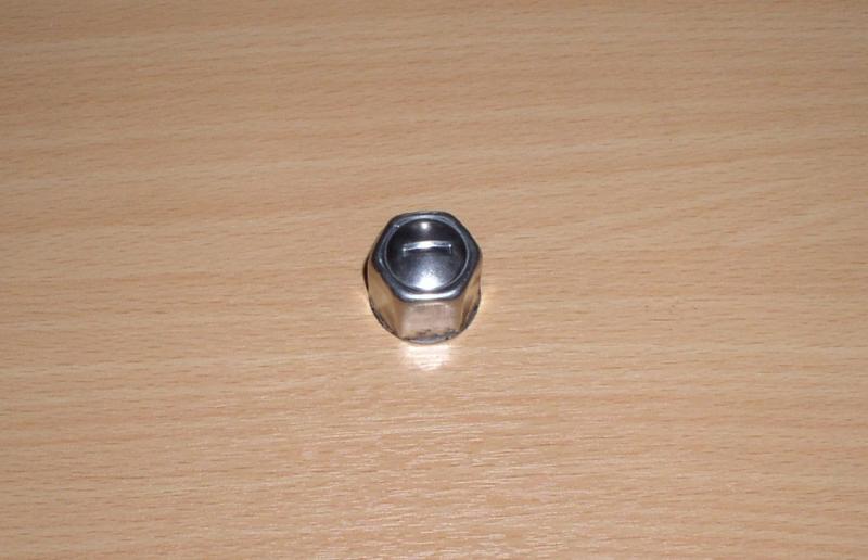

Check you actually have locking wheel nuts fitted. They may have been replaced with ordinary ones if the key was missing. The dummy covers on the locknuts have a slot pressed in for identification:

I'd say it's definitely got lockers on it GGG.
The dummy wheelnut feels like it's actually plastic instead of metal, and when you pull it off theres a short thread that protrudes from the centre of what looks like a black cylinder going back to the stud.
This black cylinder has 4 oval (ish) groove slots on the outward face, that i'm guessing the wheel lock key fits into.

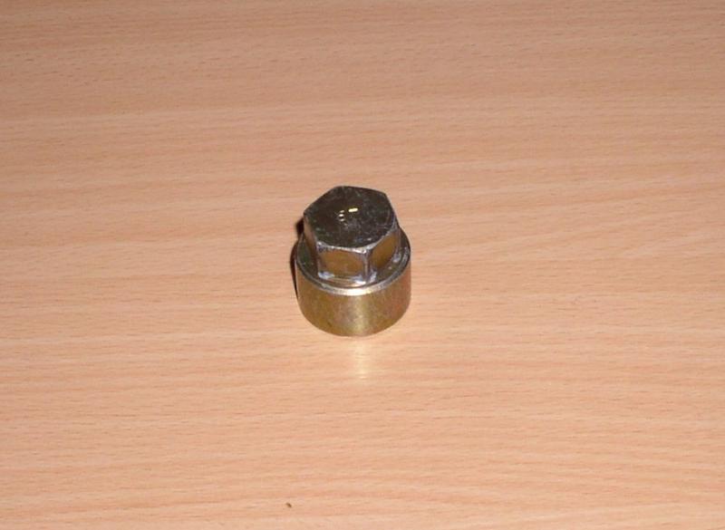

All my Jaguar's have had lock nuts with two grooves but there could well be examples with more:
The lock nut is 5cm long with an 11mm hole right through the centre.

My neighbour's locknuts look like the picture you've put up GGG, with the 2 slots. Mine are different though, probably aftermarket ones.
I suppose this means i won't be able to get a 2 digit code for them from a Jaguar dealer, because they're not Jaguar lockers?

In my pre-occupation with the heater, Instrument lights, washers and wheel nuts, i'd forgotten all about the Auto stability, traction control and restricted performance errors.
Sorry GGG.
I've got my fingers crossed for the V5 arriving late this week so i can get the battery, after a visit to the dealers
I'll also try to figure out how to fit the heater control valve.
