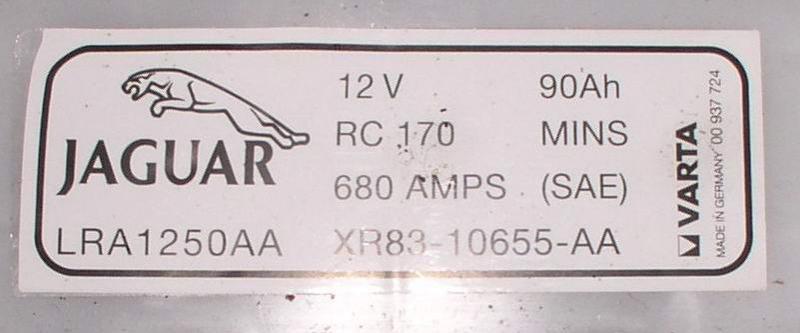

Originally Posted by Roadhogg
What is a CEL............I think the battery may not be the right one for the car, there are 2 slithers of wood on top of it that the holding brace presses down on, as if the battery is smaller than it should be in it's space.
Is there a heavy duty battery that can be recommended for these cars?
I think i need a new one...............
CEL = Check Engine Light a.k.a MIL (Malfunction Indicator Light)
The original battery fitted to the car would be VARTA LRA1250AA:
Hover over the images to enlarge them.
Replacement from Jaguar is around £120. Same battery elsewhere from just under £100.
Other makes will fit but it's important to have the vent pipe fitted.

OK just had a look, try not to laugh too loud lol.
The battery is a 45AH 420 amp job, looks like the battery off a ford fiesta or something.
Would you happen to have another piccie showing the vent on the battery by any chance GGG?
I can't see the vent pipe from those pics and i'd like to make sure i get the right battery, vent pipe included.

Back to the issues at hand i've seen plenty of batteries for XK8's on ebay today, but none have the vent pipe. Maybe it's an extra. I'll check it out, get both, do a reset and see how she goes.
Thank you again to everyone, you're all teaching me. I just wish i'd known when i went to get the car, what i know now.

The correct battery comes with a small right angled plastic outlet. The flexible vent pipe in the car pushes onto this. I've just had a look on eBay UK and there's plenty of batteries but few of the right ones and they aren't cheap at the moment. Give the Jaguar Dealer a ring. You nothing to lose making an enquiry and could be pleasantly surprised at their price. I've ended up buying my last two at the dealer after comparing prices.

Replacing the battery should be your first step these cars are dependent on a healthy battery. Your next step should be to read your OBDII codes and jot them down (all of them) and then clear them. Doing this you will have a record of what you had and if the codes comes up again I would say you need to investigate it.
