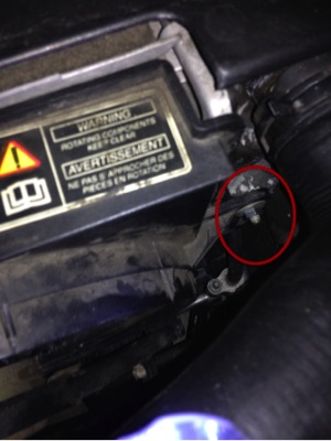

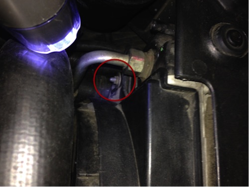

- There are two screws
- If you undo both of these and remove the two connectors from the
bottom of the fans the unit will slide up and out of the engine bay.
Note: The nuts and bolts are nopt captive and will fall in the engine
bay if you do not capture these. In addition access to the
driver side nut is extremely difficulty. To replace this I had to
use my son, who had smaller hands.
See Pic 2 and 3.

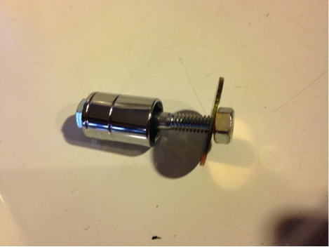

One tip: I tried the 'special tool' bush mover I'd read about somewhere else, but I just ended up with a collection of bent washers; hell this bush is tight. But - there is room to get a ball joint splitter on the lug and that worked a treat. Still needed a couple of gentle taps with a hammer, though.
