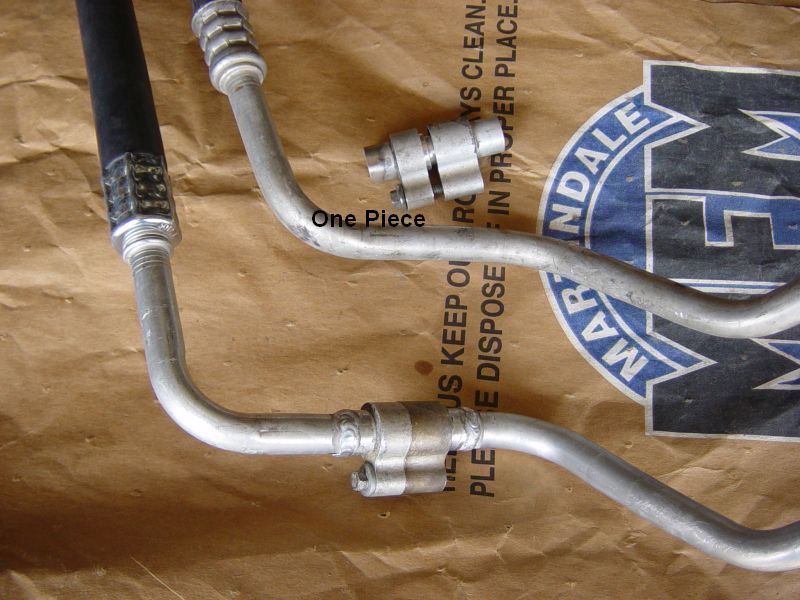

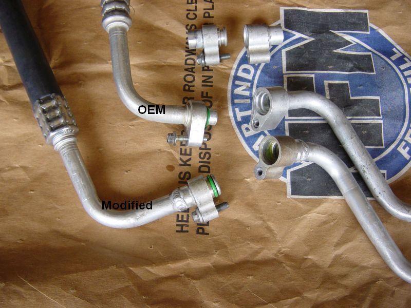

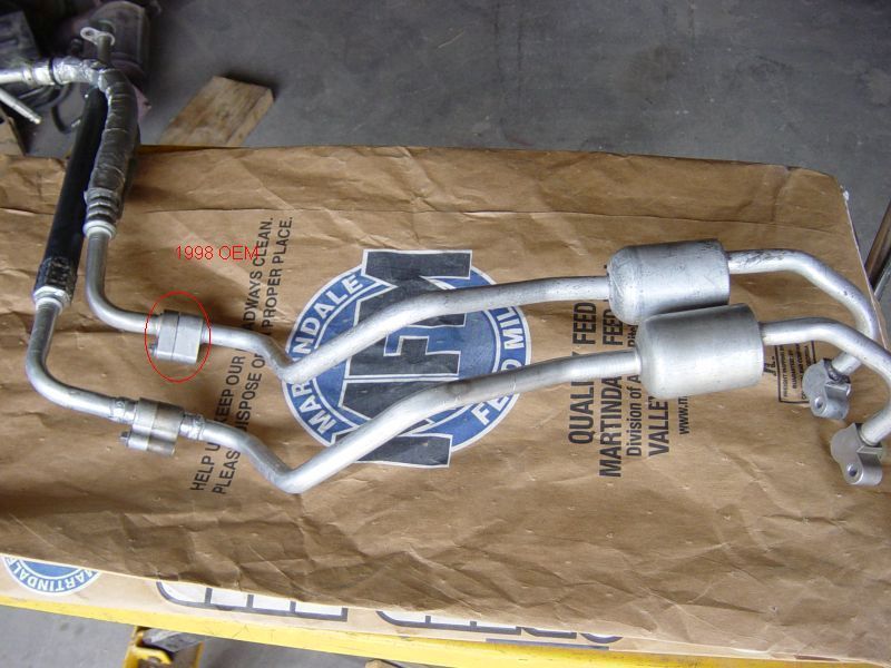

I do have the A/C ferrule crimp tool but I still want the ease of the original 1998 style suction hose.(both the X308 and X100 used the 2 piece pipe)
1999 started the ONE piece suction pipe but Jaguar reintroduced the 2 piece in 2001.
When I worked at the dealer we got TSB 412-10 about the pipe.
I wanted to duplicate the pipe as Jaguar no longer offers A/C pipes/hoses for the older cars.(NLA)
X100 oil cooler pipes are available used so I bought some from salvage yards and modified the one piece A/C pipes.
The A/C lines are 16mm and the oil cooler lines are 18mm. They can be TIG welded together.
