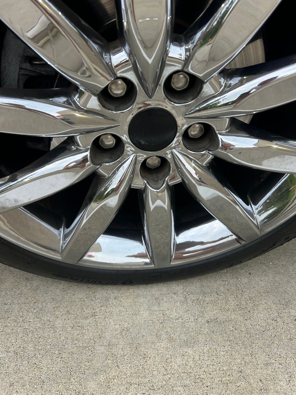

My center cap fell off, glued it back on with gorilla glue which only lasted a week. Any suggestions of something more permanent? Thanks

Would it have to come out for changing tires?

Yes, for balancing.

The front plastic caps seem to get loose because of the heat generated by the brake rotor.(rear not so much)

I used a dab of RTV when I had the problem. Still holding up.

Gorilla Glue only works when it is kept under pressure until it dries. One glue that I always keep on hand is e6000. It's like liquid duct tape, fixes just about everything, I have even used it as insulation for bare wires. It will hold those caps on. I wanted to upload a photo of it, but for some reason it will only 90% and hangs.
