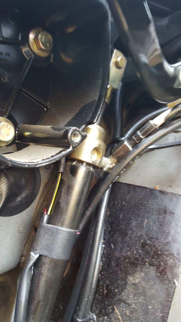

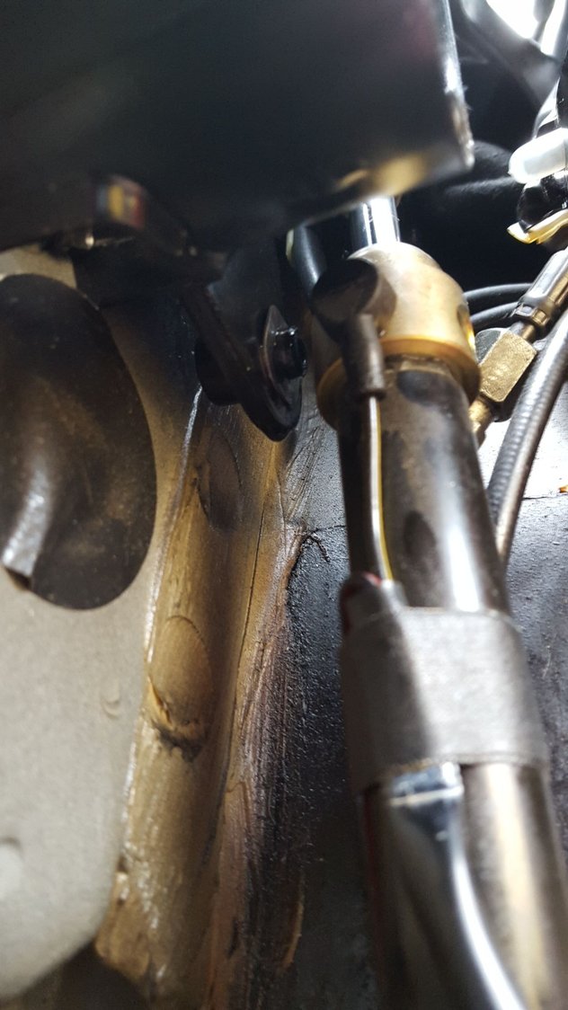

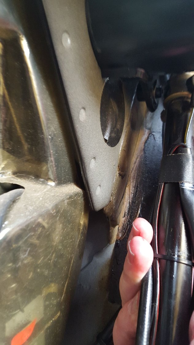

Gus,
I removed the passenger back speaker. The ram cylinder is just hanging by the hoses. I see the pivot point where the cylinder is held, but no way to keep it on there. Any thoughts.
Also when people say the switches on the ram on on the right hand side, I am assuming they mean the passenger side.

Gus
Here are some pictures.

Yes you are missing a few parts. This illustration shows the cover you are missing look and see if it fell off in the car
Link JagRepair.com - Jaguar Repair Information Resource
