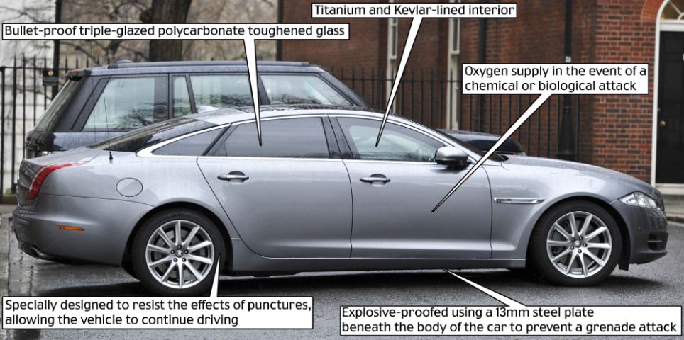

Originally Posted by test point
Your '05 is in the 'bullet proof' era of these cars...
The *only* bullet-proof Jaguar:
Attachment 99637
I have absolutely no need for a bulletproof XJ. But I want one, because that's awesome. Preferably in R trim
Attachment 99637
13mm thick steel floor - hopefully that will last a lot longer than mine did.
